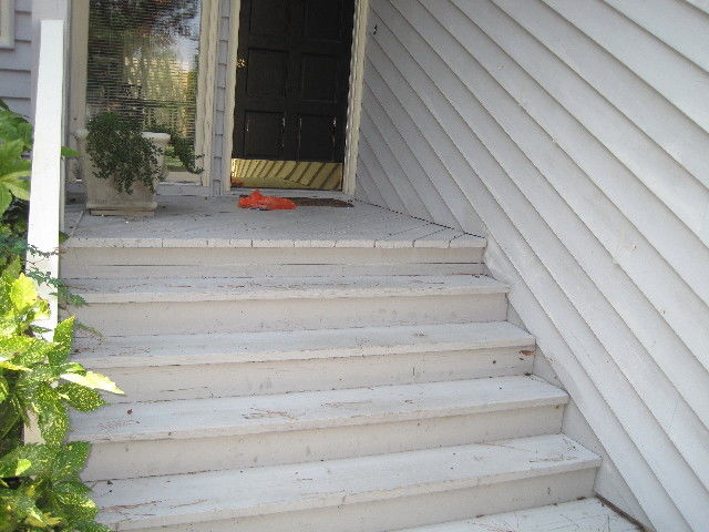

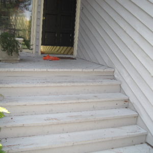

Does anyone have any pictures of handrails for one side of exterior steps? The side up against the house?
My house has lap siding, on a diagonal. The fall of the stairs, is such that if I match the existing handrail’s fall or slope, by putting a handrail on the house side, the fall of the handrail will not match the diagonal of the siding- seems that will look funny?

        3. edwardh1 | Aug 28, 2011 02:35pm | #7
          will add a pix
          what would you do for a side handrail up against the siding?

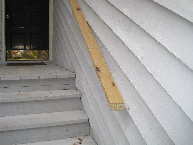

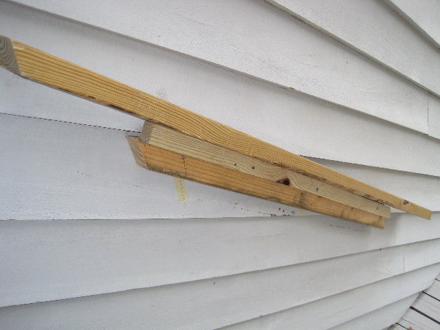

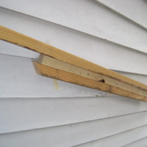

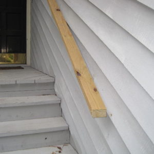

  4. edwardh1 | Sep 13, 2011 05:33pm | #15
    not looking good (see pixs - 2 of them)
    I have been playing around using scrap wood.
    I have a 2x4 as the top rail so it will match the other side.
    I can only get to about 3 studs, hence the short under rail support piece. What I need is another type support bracket.
    i can make this look btter but it still wont look nice. How would a designer/builder do this on a new house? Not like this I bet.
