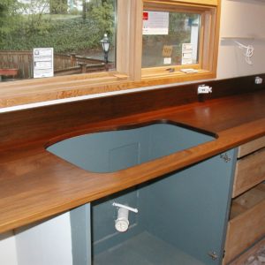

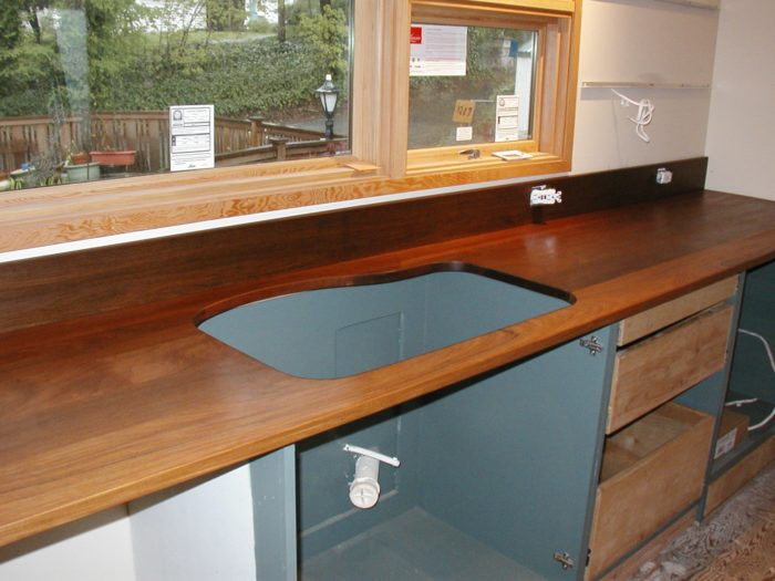

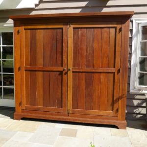

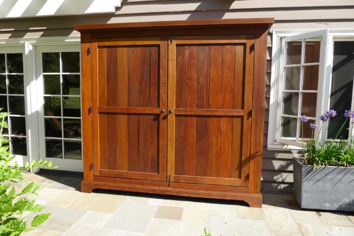

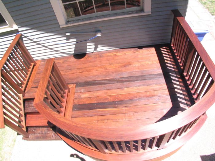

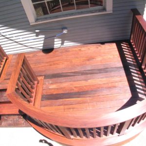

    A couple pics of some exterior ipe glue ups, and interior ipe countertops below:
