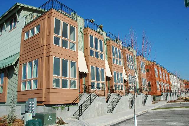

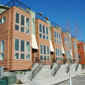

  13. wallyo | May 22, 2008 07:44pm | #32
    What about grouted cinder block, more money earthquake issues, engineering but no upkeep chance of rot etc. Still don't understand why not one common wall? At five inches lets suppose there is an even slight earth quake damage even to the foundation of one unit. How are repairs to the one made with out touching the other.
    What do you do with the footing how does that not become shared?
    Back to my prefab the attached pictures are of modular units on a foundation, they were lifted by crane into place. But the size of your project and conditions may not make it viable.
    Wallyo
