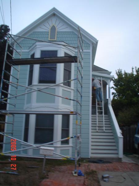

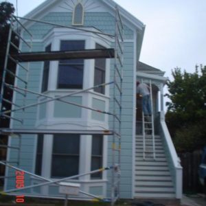

    Try a search for trex window sills.
    You rip a 2x4 at a slight angle and you get two pieces for sills
    Install after window is in.
    I did it on these windows, you can see the look in  this pic.
                                Mike
