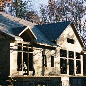

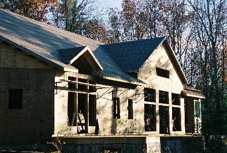

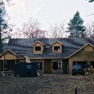

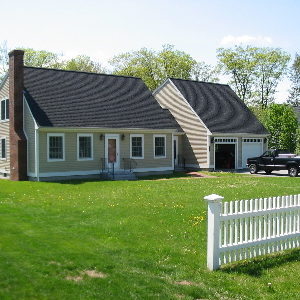

We finally finished with the housewrap and are going to start trim and siding in a little while.  We’re going with Koma trim, and would like to use a fairly wide trim around the windows, probably 5 1/2″.
We don’t want anything too elaborate.  Our house is a kind of modified cape and we have Andersen casement and awning windows. (I’d like to post a pic someday, but when I get the photos on disc they’re each over 1m and I don’t have a program that’ll let me resize.)  My husband and I have differing ideas of what looks good, so we’re looking for different styles to see if there’s something we can agree on.
Does anyone know of a good source for finding different styles of trim?  Or what is your favorite?

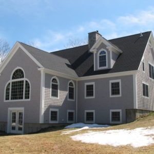

    Anderson's have a vinyl nailing flange around the perimeter. You need to rabbet out the back of the trim so that it will lay flat to the wall. I don't know what Koma is. Another issue is having enough thickness for the siding you are using. You don't want the siding sticking out beyond the trim.

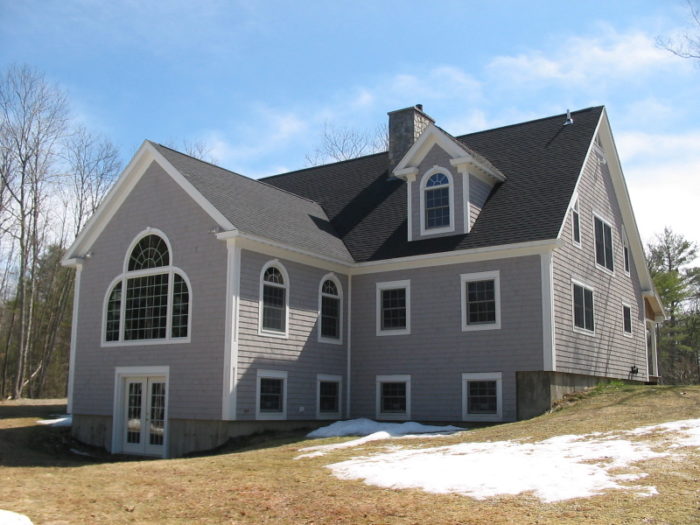

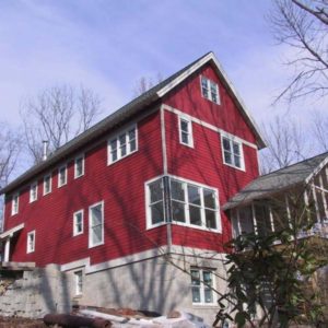

    I used 5/4" pine on the houses below. I added a simple cap to the header and notched the ends so the siding could slip behind the molding and not have to be cut around to fit. The sill piece and ends of the side casings were also rabbeted so the siding could fit up under. I figured the width of the trim to come close with the siding exposure. I didn't want a little half inch of siding to have to go under or over. You also need to know how the siding will come so that the notches and rabbets are sized correctly.

        I find that a 1 1/8" x 3/16" rabbet is about right for the Andersons, you don't want it too tight. I cut mine with a stack dado on the table saw. One thing I have found to watch with the Andersons, is the bottom flange. There is a lip that is the thickness of the vinyl which sometimes hits on the sheathing, preventing the window from sitting flat on the wall. You have to lift up on the window when installing in order to clear this edge. This is barely noticeable until you go to cut a rabbet on the trim. I haven't used synthetic trim so I don't know how a cut will affect the boards integrity. One product a salesman gave me had a foam like core. I don't remember the product name. It doesn't look like you have enough room on the sides of your windows for a wide piece of trim, if any. Are you using corner boards? If space is as limited as it looks, you may only have room for a cornice piece over the windows. The Koma website mentions moldings and gingerbread as well as sheets. This leads me to believe that it is solid throughout and can be sawn and molded. Contact the company. I don't think I would mix materials, they may weather differently and require different maintenance, but I'm guessing. This won't be an issue if the Koma is workable. The best way to handle the plastic snow is to use a form of dust collection at the saw or router like a shop vac. Don't forget to come back and show us pictures of your results.Beat it to fit / Paint it to match

          Because we're working with a foundation that was already in place (with some crazy angles), each of those two rooms in the front only has one window.  We went with bigger windows to try and maximize the amount of light coming in, so I was thinking of running the trim right to the corners, similar to what you might find on a bay window.  There is also a brick legde around the perimeter of the foundation, so we're still toying with the idea of stone up to the bottom of the front windows and around the bottom part of the garage.

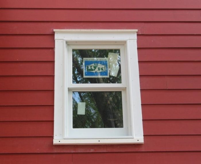

    Here's is what I did on our house.  Azek sill, Miratec 5/4x4 casing, and Azek drip cap.  Pretty easy to do.

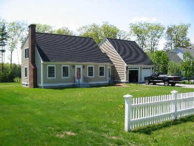

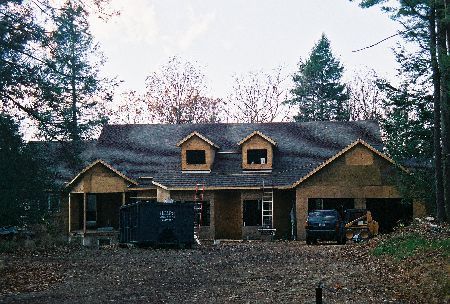

      Okay!  I finally got the pictures to upload... and didn't do anything differently than I did last night.  This computer is my material that I love/hate to work with.  Now the only problem is that I attached the back of the house twice and left out the front.
      Edited 7/26/2005 9:28 am ET by shaunaw
      1. lunabean1 | Jul 26, 2005 04:30pm | #13
        Here's the front.  So we're looking for a simple style to match the feel of the house.  Sorry I don't have a pic with the windows in; I can't find the disc.

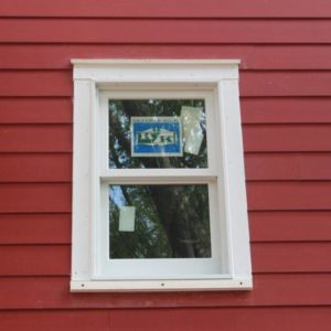

  5. Dave45 | Jul 26, 2005 04:36pm | #15
    Here is a picture of a trim I make when I do window replacements.  I use kiln dried 2" x 4" and make a frame that goes on over the nail flange.  The bottom board is angled at 10* - 12* so water runs off.  Most of my customers like them because they add a bit of architectural detail - and they make it much easier to remove the window if it's ever necessary.
