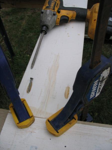

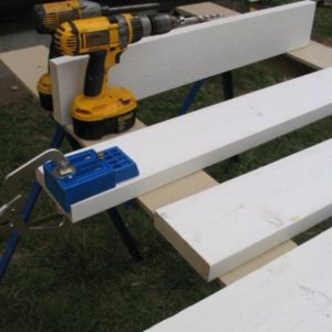

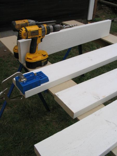

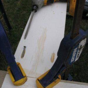

I asked a carpenter buddy who came to work with me on a job if he’d ever thought of using pocket hole joinery to build exterior window and door trims on the ground, then nailing ’em in place as a unit.  (I think I might have asked here if anybody’d done it and some do maybe.)
He said SURE!

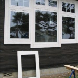

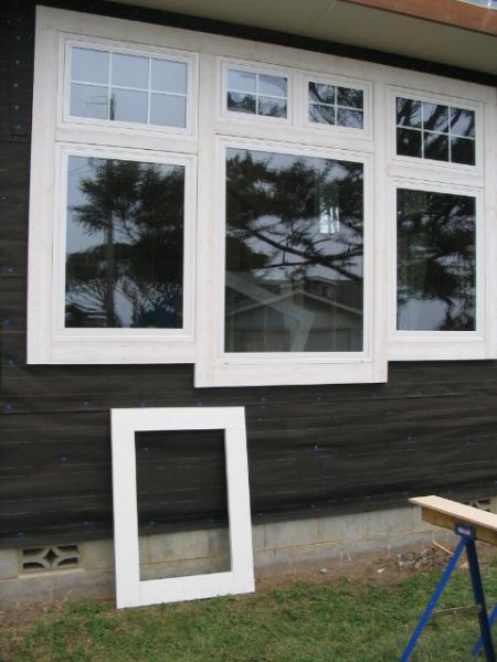

We were careful when we installed multiple windows in a unit to get a uniform distance btw them and level and plumb–all in plane.
Then we measured outside dimensions of all of ’em, added a 1/16 each way for a caulk gap (I would have liked to go a little bigger for caulk and fudge factor but it worked great with a 1/16th) built all the casing units on the ground and put every one up without one mistake or problem.
Even the 6 windows in this front wall went without a hitch.
These casings are 2x spf and we used 3″ Fastap Deck screws and glued with Titebond III.
The other thing we were able to do is put a vertical channel on the inside of the unit for drainage next to the window frame (these have a hollow behind the frame) and we routed a 1/4″ drip edge on the bottom of the unit, then primed the whole thing in and out b4 putting them up.
When we put them in place, I had a handful of laminate samples as shims to center it or get a nice reveal for the caulk line around the window frame.
