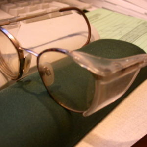

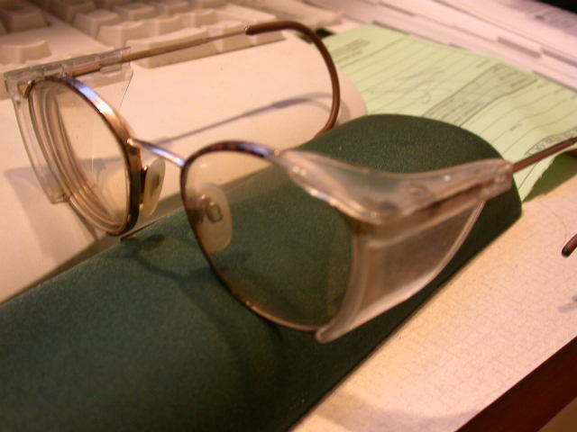

      i  also lost partial site in one eye..... ever since  ( about 2000 ) i wear safety lenseswith side shields from morning until i get home at niteMike Smith Rhode Island : Design / Build / Repair / Restore
