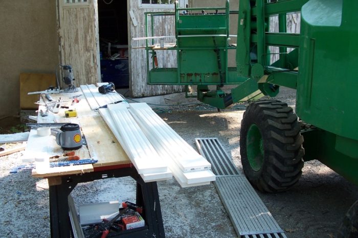

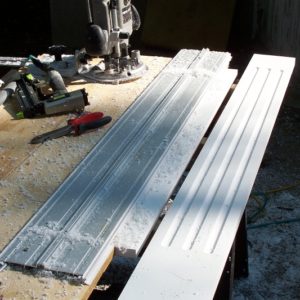

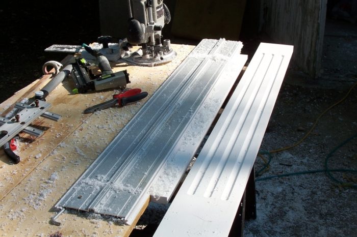

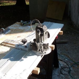

I am wrapping up some dormers that were in bad need of a face lift. The HO wanted as little upkeep as possible, and durable materials.  So we went with all azek trim except the crown that was original to the 1915 carriage house. That crown is cypress, and two pcs. did not survive removal and stripping of paint, so I hand planed out some 8′ for replacement, I just happened to have some 12/4 x 12″ Cypress I could get it out of.
Any way the ideer of a fluted pilaster was mine, just to give it some 3D in the front, a flat facade with window trim just said “eeech” to me.  So, I figured I know at least 4 ways to cobble up some fluted pcs., but I wanted to expeiment with the EZ Guide, so I went with that route.

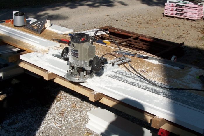

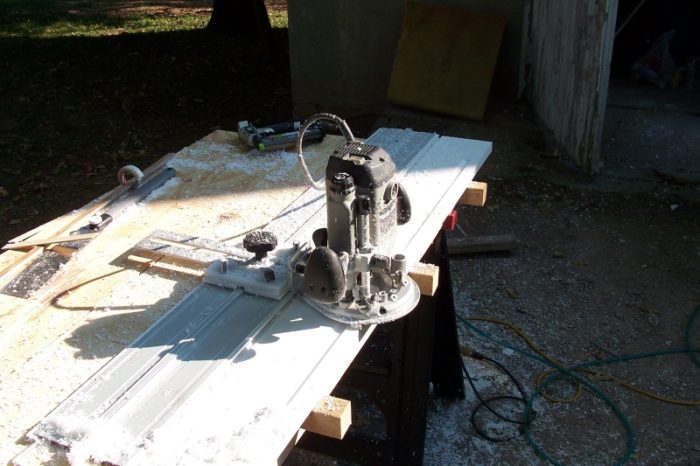

I chucked up a 3/4” core box bit in the PC, and double stick taped it to the router base for the EZ…I didn’t trust that..I had visions of the tape failing ( it was kinda old) so I tookoff the subbbase and xferred the screw holes to the alum base, drilled and C-sunk the holes.  Now I felt safer.View Image
The 5/4 azek and the guide rail worked really well, by jacking up the guide on some 3/4″ ply on top of a folding cut table I cobbled up, it is 2×2″ that fold like a parrallellagram (SP?) ( tired)…betterthan an EZ table IMO.
The router base was just shy of dropping down far enough, so I taped a shim on teh outboard side of the base to stabilize the router from tipping, and then squared my start and stop lines (I eyeballed the cut to the lines, no fixed stops) and toe pinned the azek to the table rails..rout one edge, blow it all off, and flip and rout the other edge. After all eight were done that way, I just cut an 1.5″ spacer (3/4 flute+3/4 flat) and routed the center flute. Slick as snot.   View Image
Finally, I chucked up a champher bit in the ancient Ryobi trim router and gave the edges a swipe the same length as the flutes, allthat is left is cut the top to meet the upper terminus and bevel the bottom to the roof pitch, which I would have completed today, but the boom decided to die again..so maybe tomorrow.

    About the EZ...faster than a router table?  maybe. but stops would have to set, routing upside down..faster than just a straight guide fence? no, but less chance of error...faster than template guide bushings and a template? Probably not.
    I did it cuz, (A) I had it, (B) I had not tried it yet, with a router and (C) It seemed like good ideer at the time. I gotta admit, the PVC dust is abrasive and not slippery, I applied powdered MICA to the guide and it was much smoother.  I had just seen a display of Fypon fluted millwork at the lumber yard, I could not believe my eyes, on a 5 flute sample display, TWO flutes were a 1/2" long or short of the others!!!  Sloppy as hell. I SPLIT my pencil lines by eye..geeze, it ain't THAT hard.
    Any way, I am not starting a festool/ez debate, I used what I had, and it worked as promised..nuff said.
    Next time, I get a vacuum hooked up tho', I have azek dust in places I didn't know I had..and it will, find a way into yer eyes..and it hurts.

      I have done flutes both ways and prefer it overhead like you did than ona router table.Now try getting five flutes to equalize!;)

        5, I woulda set a stop..LOL I aint THAT good.Spheramid Enterprises Architectural Woodworks

    Did you order an extra 50inch guide to have or just take apart the 8ft full length guide when you need the ease of a shorty?

      I got two 50" and a shorter 25'' (?) guides. So, yea, the shortest was too short, but one 50" was about right.  I cheated and piffen screwed the end down opposite the plywood end that had the EZ clamp unnder neath.  It woulda flopped around too much to rely on just that end clamp.

        A new use for the hanger holes already in the guide or did you need to drill new ones?
        So does the 25" guide see any use at all or do you assemble and disassemble the 8'er when you need the shorter length?

          I just drilled a hole out towards the end, zipped in a screw. Nothing fancy, didn't even CSink it, being as the router guide doo-dad stopped before I would travel that far.  Other wise, it would have made a handy stop, but I didn't get that anal about registering to the jig in that direction.
          I have not even cut the edges of the short rail yet..wassis? 2 yrs? I see it could be handy for cabinetry, like dados and plunge routering line holes, if one were so inclined.
          I use the 50" rails for about everything, but I need to get the new base on the PC saw, blade left, I hate the Milwaukee set up blade right..seems backwards to me.
          Gonna play with the route set ups more I think, I like that a lot, I just wish the router doo-dad was a "T" slot or dovetail, it CAN jump the track, and that could be a bad thing.Spheramid Enterprises Architectural Woodworks
