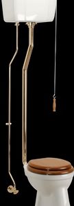

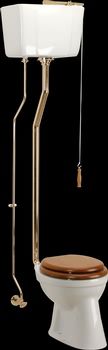

  9. gb93433 | Sep 24, 2006 09:44am | #23
    I am no expert in this area but how about a toilet with the tank up high and a pipe coming down. If I remember right they take up less space.
    You could also use a toilet from a 747.
    Edited 9/24/2006 2:45 am by gb93433
  10. gb93433 | Sep 24, 2006 09:49am | #24
    A 747 toilet and the old vintage toilet
