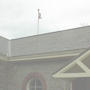

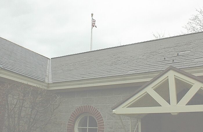

        1. Piffin | Jul 20, 2005 02:44am | #20
          here they are again. The library( fake slate comp real.jpgh) I believe was Eternit brand, left of valley original slate 90 YO, right was new Etenit.
          Photos labeled fake slate and slate immitation were on anot6her house new three yuears ago and looks like Eternit also, but I can't verify that without a couple phone calls

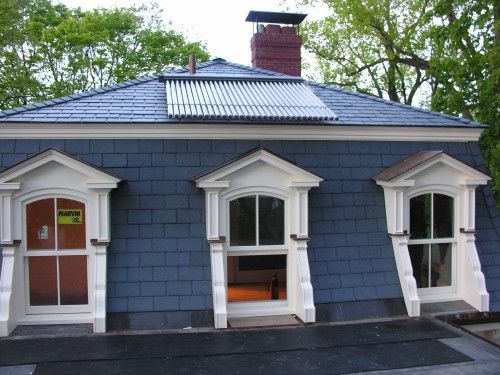

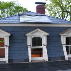

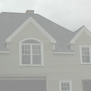

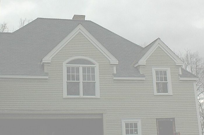

    constantin | Jul 19, 2005 04:01am | #2
    I elected to go with DuraSlate, which is made by North Americas largest producer of PVC, IIRC. So far, I have been very happy with it. A picture of it having been installed on our roof is attached. I was quite impressed with how easily it went on. Carving custom shapes is quickly achieved via a grinder wheel.
    Since our roof is 35' off the ground, it's pretty much impossible to tell that the slate is fake, were it not for the uniform color dispersion (which the historical society wanted), and the fact that slate has never come in ridge-covering varieties. Nonetheless, I figure that the longevity of the product is almost a given in our cold climate that has very little heat stress compared to other parts of the country.
    Depending on your local climate, I would look into the performance of these variations of fake slate when the temperatures get very, very hot. So far, I am very happy with the DuraSlate. A nearby garage that has had it for a long time still looks new, even though their version of the stuff was black, i.e. the most likely to curl. The curling is allegedly worst whenever you're dealing with rubber-compounded slate, if I remember the posts I have seen here on that subject correctly.
    Edited 7/18/2005 9:28 pm ET by Constantin
      JeffBuck | Jul 19, 2005 04:21am | #3
      wow ... with all that great trim ... hard to even notice the shingles!

      1. Piffin | Jul 19, 2005 04:32am | #4
        wow too, a pipe organ palace!All the failures of such products I have seen were in the recycled rubber catagory. I haven't yet seen these you mention, but like CU, I lean towards Tamko, having had good products from them. but the jury is still out for me on this kind of new thing. i'll take a back seat for a couple of years to see what happens.
          constantin | Jul 19, 2005 04:38am | #6
          Now, now, go easy on our solar hot water heating system. You have hurt its feelings. :-PBut seriously, between the GFXTechnology heat exchanger in the basement and the solar hot water heating system on the roof, I hope that we can give our boiler the summer off. The solar hot water system heats the water, the GFX stretches the supply. It'll be fun to see just how well the whole thing will work.
