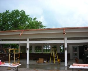

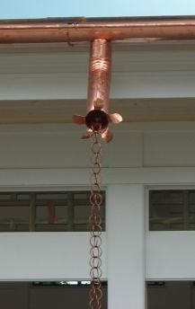

Had a situation where there was no good way to get the downspouts to the ground. Dale and the HO came up with this. The chains will terminate in urns set on the carport apron.

  1. Henley | Jun 29, 2008 02:29am | #1
    Any idea how much over spray or slash you'll get?
    I was looking at those but the manufacturer described them
    as meant for areas with small amounts of water.
    1. seeyou | Jun 29, 2008 02:39am | #3
      Probably quite a bit. But it doesn't matter in this case. The soffit is about 3' wide and we've added about 18" of downspout to project the water out into the driveway. In light to medium rains, they'll work fine. In downpours it doesn't matter. Snow melt might be a problem. We'll see.http://grantlogan.net

          2. seeyou | Jun 29, 2008 02:59am | #7
            Hey make sure and report back how it miraculously doesn't spill a drop so I can get one.
            They splash like hell if there's any roof acreage at all going thru them. You don't want to use rain chains unless you've got good soffit extension distance.

            Those are neat . The trick with the chain I learned is small tight links keep the water flowing down the chain and really reduces splashing, the more surface area for the water to run down the better. I cut the chain long enough to drop a 4" or so length down into the drain upright. This helps anchor it from wind and guides the water right where I want it. Periodically I have to shake the chains to loosen up any debris that gets caught in the links.
      2. dovetail97128 | Jun 29, 2008 08:43am | #10
        I have played with chains for downspouts quite a few times over the years. Best ones to date are made up out of small link chain (same style and size of link as is used in choke chains for medium sized dogs).
        I make a ring that is larger than the down spout opening and hang 6-8 of the chains like a curtain around the the ring. The water flows nicely down the small links and the circle of them contains the flow from all but the heaviest of downpours with in it. They actually have an interesting "wooshing" noise when it rains hard. the water flowing down the links is broken up in it's flow like a small brook running over gravel.
