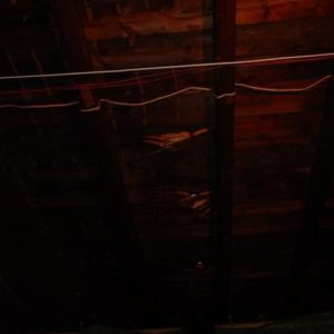

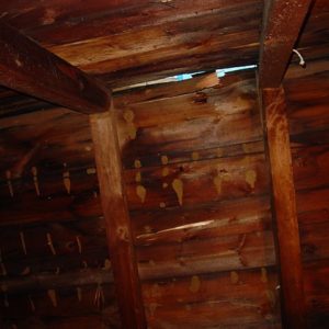

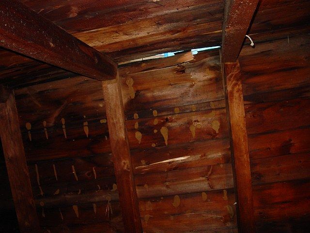

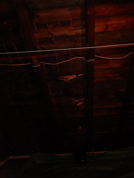

p.s. I won’t be using a gun- heres the underneath of the 1840 deck
