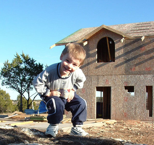

This is a picture I took of my son standing in front of our house last weekend. It has not been digitally modified.
And for those of you up North… yea, I know it sounds like another tall tale, but that really is what the weather was like too.

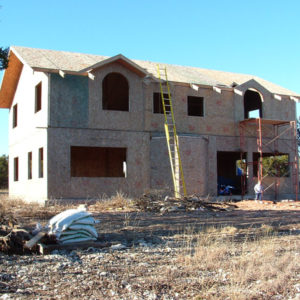

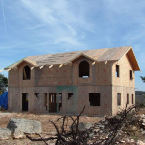

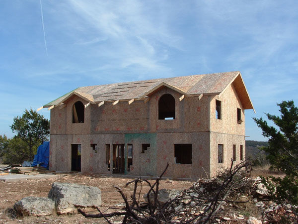

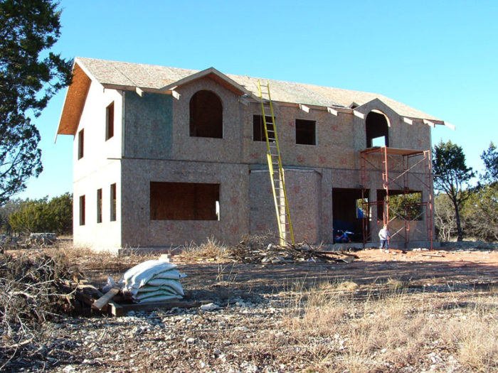

      Well.... maybe, just a little. Those openings by the front door will be glass block. The proportions are a little off right now but the garage, second story deck and wrap around porch are not framed yet. The 6/12 roof drops to a 4/12 on those appendages and should balance things out pretty nicely.
      Here are a couple more shots from a little more realistic perspective.
      I'm not winning any construction speed records for sure but I'm making progress... one weekend at a time.Kevin Halliburton

          GoldenWreckedAngle | Feb 14, 2004 05:21pm | #17
          No, I had to re-cut every one of them. I also had to cut the dimensional lumber splines that tie them all together. Talk about compound angle cuts! Every edge on those valley splines was beveled and mitered - in fact, some of the ends had multiple intersecting bevels and miters. Some real head scratchers there...Kevin Halliburton

    I like the overhang as shown on the shot of the side wall. What is the overhang?
    An ex-boat builder treading water!
      GoldenWreckedAngle | Feb 14, 2004 11:25pm | #20
      Bob,
      The house is built out of Structural Insulated Panels. I wanted a large overhang for solar control so I ran the dimensional lumber splines on the roof panels long. They will be left exposed and wrapped in either cedar or copper depending on what the budget allows. The metal roof will come all the way down to the end of rafters to get the water and sun off the walls.Kevin Halliburton

    Serious though, your gonna have a well insulated house with those sips. The shot
    with the joist going into that outside wall w/joist hangers, is there framing behind
    that osb, or is the osb strong enough to carry that load?
    Looks like time for some tar paper on that thar roof.
    1. DanT | Feb 14, 2004 02:01pm | #13
      Cute kid, nice looking house, P-sses me off you have green anywhere in your landscape!  DanT
      GoldenWreckedAngle | Feb 14, 2004 05:11pm | #16
      Ok, you guys are right - toe boards on a 6/12 are overkill but since I'm on the job alone quite a bit I take a lot of extra precautions. In reality, I found the toe boards were more in the way than they helped. That's why you don't see them on any of the later panels I installed. I also tie off with a harness every time I get up there. It's extremely important to me that I make it home to see that boy every night.
      Those joist hangers are overhang joist hangers. The ears fold over the top of the wall and nail into the dimensional lumber top plate on the panels. The ends of the joists are also slathered with structural adhesive and structural screws are run through the panel into the ends of the joists. The second floor decking goes over that all the way to the outside edge of the panel then the base plates for the second floor panels are nailed and lag bolted over that. Kevin Halliburton
