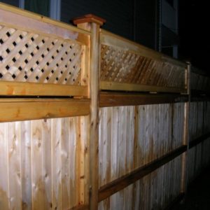

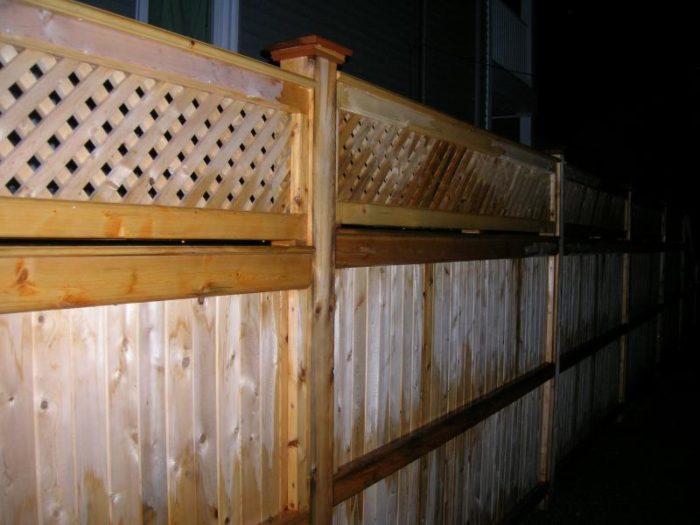

    I just built a 110' foot fence where I shiplapped and v-grooved 300+ pickets, (4 passes each board on table saw) , made my own latice too (wanted to copy Walpole Woodworkers) I nailed pickets to cross braces (2x4's) with stainless steel ring shanks. Major stuff like the lattice toppers were screwed with 2 or 3" stainless screws and gorilla glued. Took some time but it'll be there long after I'm gone.
    Just waiting for a sunny weekend to scrape the glue, fill holes and blast that baby w/ Sherwin W's A-100 then w/ Sherwins solid stain, maybe grey. Again I copy walpole.
    This is for my house, I am by no means a pro, just too cheap to hire someone.
    Alan S
