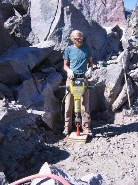

Made something like that when I was in need of a plate compactor last summer. I imagine it would work quite well as you're talking about, with a small plate. Ours was a classic duct tape and baling wire job, along with 4 layers of 3/4" ply for the plate. It did it's job, though.

Looks like you've got a lot of rock to break there. Better get busy!
If Tyranny and Oppression come to this land, it will be in the guise of fighting a foreign enemy. --James Madison
This is the rock breaking equipment. It's done now, thank god. rock drills and jackhammers take a toll on the body.zak

You doing time! Figure you must be with all that rock to break.
