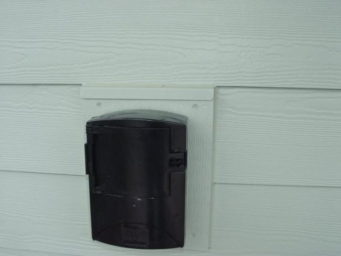

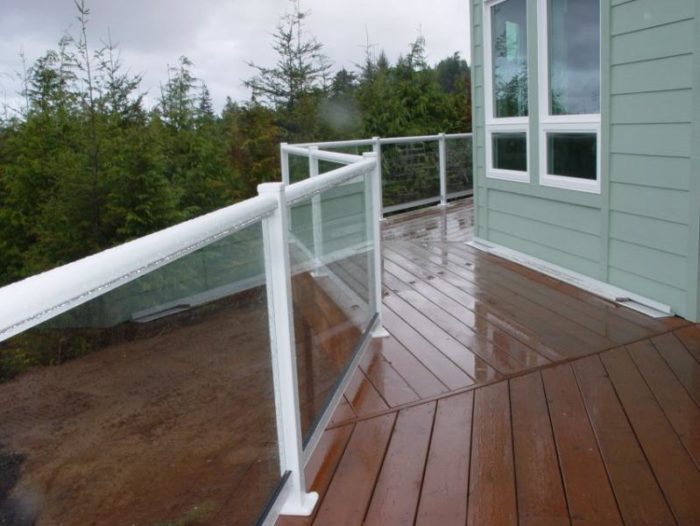

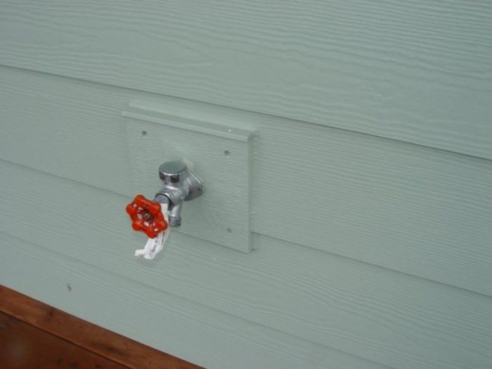

But I recently installed a glass deck rail system for a fellow contractor on a new custom home and liked the way he eliminated butt joints and finished his blockouts for fixtures.
For all his trim work, he used texture surfaced pine trimwood and had it wolmanized at one of the local pressure treating plants.
The site is on a hillside about a mile inland from the Pacific Ocean and is exposed to prevailing winds Summer and Winter so weatherization is important.
The headflashings over the blockouts are copper, custom made in a local shop but painted to match the exterior.
The deckrail is by AlumiRail. I’ve installed some Chrystalite glass rail systems, but I like this one a bit better….both are fairly straightforward, but this system seems a bit stronger.

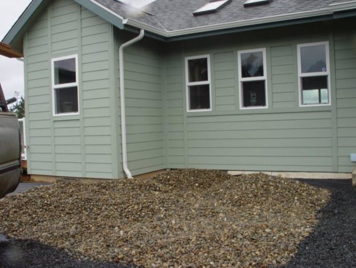

Very nice way to eliminate the butt joints...nice handrailing, too.
I don't know if I'm seeing the inside corner boards right...are they on a diagonal? Pretty cool, if they are<G>
The inside corners are just 90 degree butted, with one ripped down to give an equal reveal. I have usually used 2 X 2 for inside corners, but I think this method, with the 1 X 4 looks a little better.

thanks for the post. never did like fiber cement butt joints. I did a huge house this winter and all the butt joints show. I want to do the cement board on my house but was turned off because of this. I may reconsider.

I am using hardie plank and trying to decide how to the trim vinyl windows on my house. I like the way the window trim looks in your pictures. What did you use and can get you post some closeup pictures.
Thanks.
Dan, used primed finger jointed bodyguard 5/4 x 4 with composite sills and drip caps, painted and caulked. don't know how it will hold up, the windsor one the GC has used before has been failing on some older houses.
I've been doing Azek brickmold sides and top (with headflash) and a sill and stool ripped from Trex, which can be stained or painted (IIRC, I got the Trex idea from one of Mike Smith's posts sometime back).

One thing I didn't mention on my original post was that when my helper and I were installing the tempered glass panels, it was fairly cold out and the vinyl lock strips were pretty stiff. On the fourth panel out of 28, the glass literally exploded in our hands as we were forcing it into the upper track.
Even with gloves on, we both got superficially cut up pretty good....bled all over the deck....wiped out about a third of the bandages and gauze in my first aid kit.....
