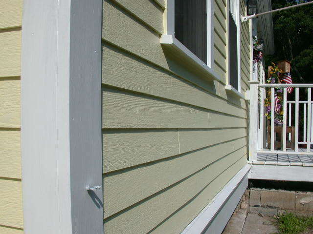

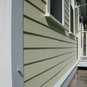

          1. Jay72 | Feb 06, 2003 01:42am | #18
            Hardie does make a 5/4 Trim board that I have used.  All Hardie products take some getting used to. The good thing is that once its up it is bullet proof and holds paint well (latex only) . My main complaint about Hardi-trim (5/4) is that to get the same reveal on corner boards you have to rip an inch off one of each pair. This creates a lot of dust as well as wear on the high dollar specialty blades we used. I just finished a Hardi job that involved facia and cornice with site built dentil moulding. We used the 7/16 stuff for facia and soffit then made dentil with hundreds of dentil blocks out of 7/16 laminated onto strips of 7/16. Also hand cut several hundred diamond shingles for gable end out of the Hardi shingles, (5/16) thick. All sidind was regular Hardi-plank and corner boards and window trim as well as arched garage door trim was 5/4 Hardi Trim. We also also built beveled cap for stone foundation from the 7/16 stuff. The only exterior elements that were not Hardi were heart pine window sills. Boy was I glad to get back to cutting wood after a couple of weeks of that stuff.
          2. carlsperry | Feb 06, 2003 05:51am | #20
            Sounds like a good job.  Any photos to share?
          3. Jay72 | Feb 06, 2003 06:08am | #21
            I'll try to take a couple pictures and post them this weekend.  The Hardiplank reps came to the job and took pictures after our salesman saw the job.  Jay
