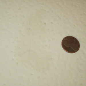

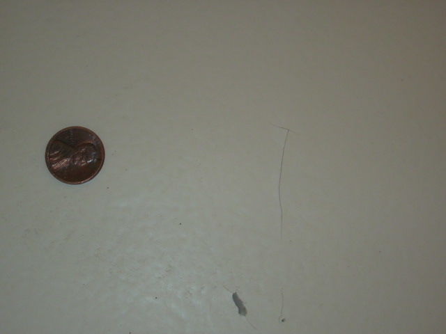

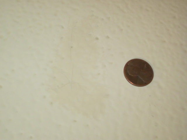

      Each tub has two or three small cracks, none of which is more than a hairline but is about 1.5 - 2.25 inches long.  No way to tell if there is any bedding under the units.

          Different sizes and locations on both tubs.  Haven't stood in either to see if there is flexing.  Doesn't seem to be any damage anywhere else on the units.  None around the drains.  Didn't see any extra caulking.  Relatively centered, but 6 - 8 - 12 inches or greater from each other.
          Unfortunately, these tubs are in a client's house that's a little mor than an hour's drive from me, so I can't go there too often.  Here's a couple of pics (attached).

            Those to me would be a concern.  I'd get a detail on what these tubs are-how they are made, whether they have any "feet" on the bottom.

            Those do not look like a dropped object-tubs chip, the surface shows a ship from a drop.  A heavy bowling ball from up high, might do what I see.

            Looking at those, particularly the first one, makes me suspicious that the tubs may have been (poorly) refinished once, and it's the refinishing that's peeling off.
            Do you know much about the history of the tubs -- how old they are, and whether the current owner has been there since they were installed?
