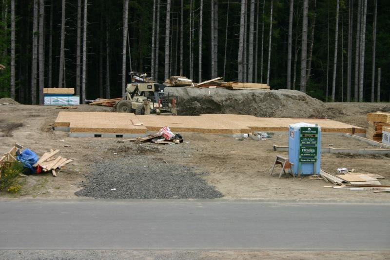

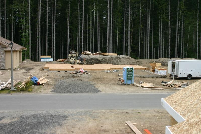

We finally started a fun house. This one has wall heights all over the place, 9’ 11’, 14’ then parts are vaulted. The roof will be 12-12 and way up there. Above the 9’ walls the ridge will be 18’ 6†plus heelstand!! We’ll be wearing harnesses for sure J
Here are some pics. I’m going to try and update a few times a week as the framing goes. Hopefully we’ll get to do some sort of trick ceilings like coves or barrels or both
The first few pics are of the floor finally done. This house is about 2600 sq and a single story so it’s spread out. There were just two of us working on it and we have to have an underfloor inspection now before we sheathe, so that throws scheduling off. We have to be done with the floor framing completely before they will pass the inspection. Of course, they never tell us when they’ll be out, so we fail the first time usually. We didn’t have the full crew until the wall framing, so we were a little slower than normal. Took parts of 3 days to get the floor sheathed and lines snapped L Jasen thought he’d be funny and have his arm sticking thru the floor. J

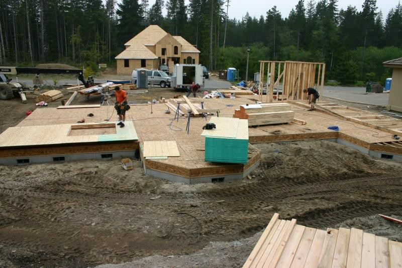

Wall framing day 1
This pic is in the morning. That stack of sheathing at the bottom is 10’ 7/16†osb so we can go from mudsill to the top of the wall. Jasen is getting ready to nail off the sheathing with Bostich Sheather Plus nails. That is a shearwall so it has to be done perfectly and he is the self proclaimed “King of the Shear Nailersâ€. We always use a router to cut openings in a sheathed wall. http://pic9.picturetrail.com/VOL293/2163851/7273486/94696175.jpg

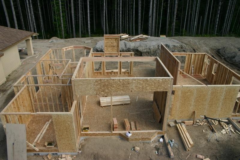

Wall framing day 1 afternoon
http://pic9.picturetrail.com/VOL293/2163851/7273486/94696202.jpg
We did really well yesterday. The wall in the back is 9’ then 15’ 10†then 9’. The 12-12 rafters will land on the 9’ walls and then rafters will go from that 15’10†wall at a 4-12 and die into the 12-12 roof. The tall wall there on the right is 14’ high and will be the dining room. All sheathed walls are shearwalls blocked at 10’ high for fireblocking & panel edge blocking. A few walls start as outside walls and come inside the house. We have to sheathe the entire wall through to the inside. Below them are the concrete stemwalls. We’ll have to drill the bottom plate and run allthread down to coupler nuts that attach to the big bolts set in the concrete.

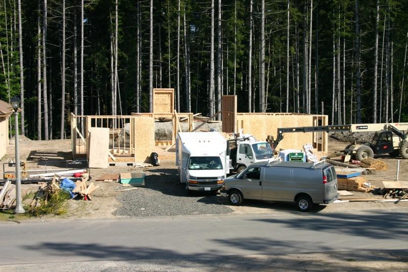

<!—->Wall framing day 2 afternoon
http://pic9.picturetrail.com/VOL293/2163851/7273486/94696245.jpg
I took this pic from about 30’ up in the platform about 90 minuts ago. You can see the 14’ walls in the front. There will be one running front to back to divide that space into the foyer and dining room. Then below that glulam will be come columns and arches. The right side octagon bay will all be 11’. We’ll frame the walls that divide that space, kitchen and nook, from the great room in the middle of the house and the bedrooms on the right. You can see the layout stick in the background. That thing is a great tool to speed up layout. Last pic is of Jasen driving the forklift http://pic9.picturetrail.com/VOL293/2163851/7273486/94696326.jpg

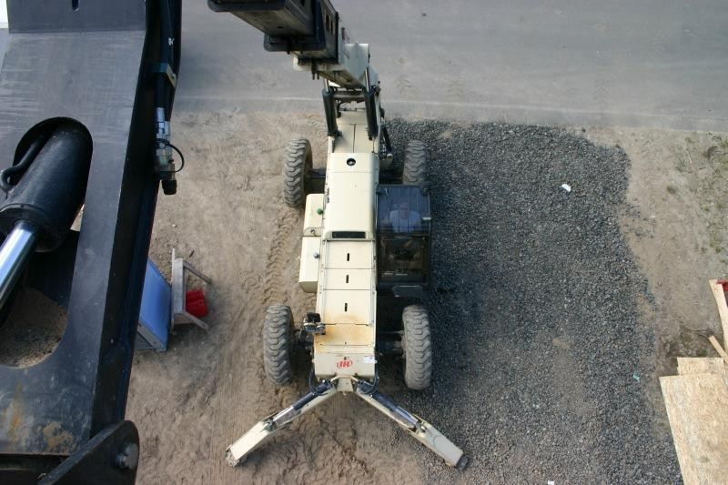

Today was a good day. It rained all day long, but we got all the walls up, plumb and lined and then framed and sheathed the garage. Monday, we'll finish up the sheathing, plumb and align the garage walls, and then layout for the roof. Should start the roof Tuesday and I can't wait.

How do you like the IR? Ours is a 2002 VR1056 with about 900 hours. Its about 2 months old for us :-)

We got the VR 6428 2001. Its been a good piece of equipment, seat was the first thing that had to be replaced. I think the big thing is, there has been to many different drivers using it. Everybody on the job sites uses it. But just like a Timex, it takes a licking but keeps on ticking!
Boomed up about 6sqs. of roofing for the roofer a few weeks back & the pucker factor was high!
We also have a Case XT 70 skid with forks for moving the small stuff.
Nice picture! Whereabouts was that taken? What's the reach on your IR? The VR 1056 will go 56' up and 42' out with the outriggers down. I've only sent the boom up that high once, in the middle of the street where it was level and there was nothing on those forks. I get scared sending it up that high :-)

Back again, Our IR will go about 25'-30' we also have a jib for setting trusses. Were outside Denver! This has been one wet spring, so were doing it like they do in the NW. Mud everywhere, many foundations in place still needing backfill when we get a dry spell.
