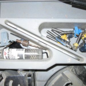

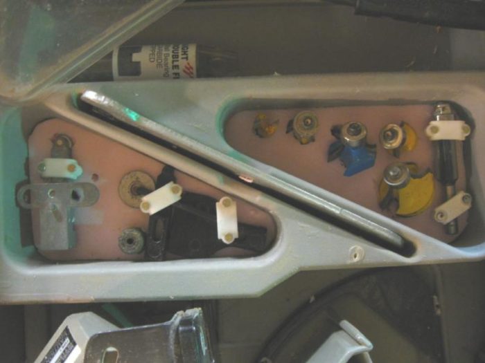

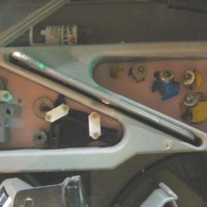

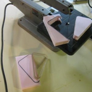

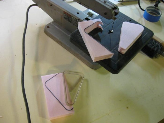

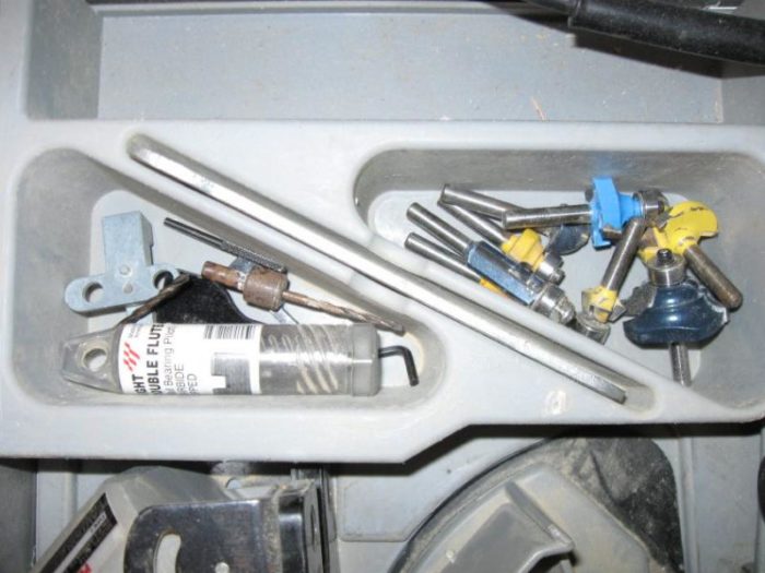

My trim router tool case has been a mess with bits banging into each other and getting dull before I even open the case… foamboard and a scroll saw to the rescue. I traced the shape of the bit storage lids onto the FB and cut it to fit the odd shape of the case. Some holes I drilled at an angle (not much head space), some bits and things I pinned to the FB with electrical cable staples.

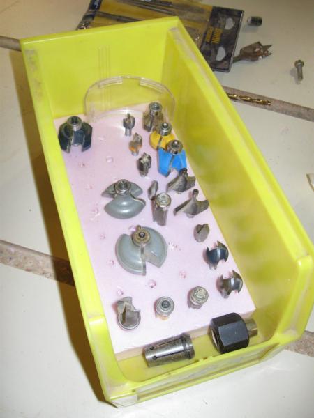

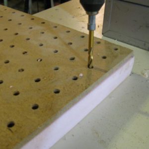

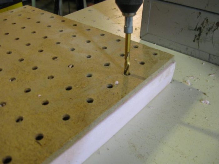

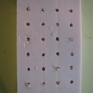

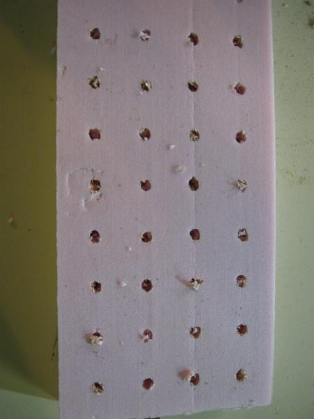

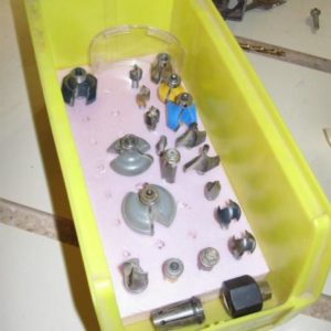

      The bit blocks I have in the shop are oak too... haven't noticed any appreciable rust though. I also made a foam bit block that fits in a plastic bin. The foam is actually hard to drill... bit wants to wander and the foam tears out, etc. My solution is a pegboard as drill guide. Keeps the bit from wandering, stops tearout, and gives you evenly spaces holes. I use 3/16" hole for the 1/4" shanks for a snug fit. Maybe another tip worth submitting. :o)

        Are you using a drill press? Most of my bits are 1/2" so I'll bump up your tip to 7/16". Yer on a roll!http://www.tvwsolar.com
