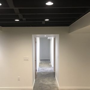

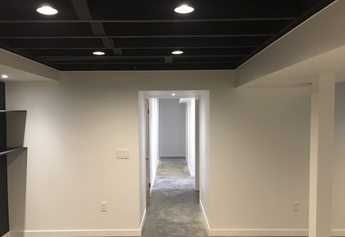

    Here is a pic of a simple basement I did awhile ago. You can achieve a very finished look w/out drywalling the ceiling. I do find that it looks better to wrap the main trunk and return of the hvac in drywall as it tends to be a bit hard and unkept looking. For the floor I prefer a concrete sealer in a matt finish, so the floor looks like stone in comparison to the shiny plastic look of epoxy. The sealer is a lot more forgiving in application as well and allows slab to breathe and moisture to evaporate into the atmosphere. If you do not have a dehumidifier I would suggest considering getting one and setting up a drain, so you do not have to empty containers all the time.

      I noticed u went with black ceiling rafters in that pic. Was it difficult to paint, and I’m assuming u did the underneaths of the floor boards too. Also like the look of those recessed lights inside the rafters.
      1. jlyda | Sep 04, 2020 01:59am | #11
        Yes, painted every surface of the underside of the first floor. It’s definitely a job for a paint sprayer. Was easy to paint, the hardest part was the prep, cleaning off all the years of collected dust. The lights are cylinder light fixtures which we installed in the joists space.
