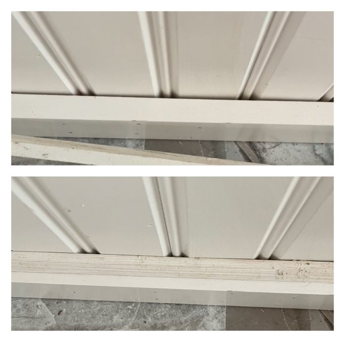

I am installing baseboard on a wall that has beadboard wainscoting installed. I am going to install a base cap to cover the gap between the beadboard and wall but that still leaves the gaps from the beadboard grooves.
I know when I caulk this with enough caulk to fill the grooves I’m going to end up with a crappy looking line with little spikes of caulking coming up the grooves.
Any tips on how to prevent that and get a nice even line?

I have some leftover board and base. I’m going to mock up a sample, put painters tape on the board at the joint, making sure I press the tape in the grooves with a putty knife. Yeah, major PITA but if it works it’ll look like better than not doing it. If it doesn’t work then I have more time to finish other stuff.

It’s really not too hard to chalk, just have plenty of water and rags to smooth it out. Sometimes I use an old 1.5” sash brush for this. I’ll wipe the caulk with a rag and get it just about smoothed, then dip the brush in water and smooth the caulk in a motion just like you would use if painting. You may have to touch up some areas again with the rag, but you should be able to get the caulk pretty clean at this point.
Chalking isn't too difficult once you get the hang of it. Just make sure you have plenty of water and rags on hand for smoothing. I often use an old 1.5” sash brush for this job. After applying the caulk, I initially smooth it out with a rag. Then, I dip the brush in water and use it in a painting-like motion to refine the caulk. You might need to go back and touch up some spots with the rag, but this method should help you achieve a clean, professional finish.
