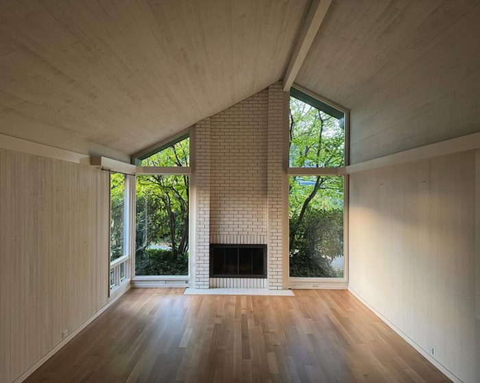

I’m renovating a 1970s house in the Pacific Northwest which has typical 2×4 to 2×6 wood framing (interior and exterior), and a good portion of the interior wall/ceiling finish has a layer of clear cedar tongue and groove fastened to plywood (fastened to the framing). The walls are up to 14.5′ tall in some places, and the boards are that long, running vertically from floor to ceiling.
The paneling sadly has been painted by a past owner and my goal is to bring it back to original finish. After some tests, I’ve judged that carefully taking the paneling down and planing the top 1/16th or so off to remove the paint before re-installing is the best move.

    Is the T&G cedar painted, or is it stained with a white stain? From the picture, it looks like it was a white stain... If so, could you just stain it with a cedar color? ( I can't imagine the work involved in carefully taking down all that T&G material, running through a planer, sanding it, and reinstalling...
    If you decide to take down all those T&G boards, and you don't want plywood as the substrate, what if you used drywall with 1/2" plywood nailing strips inlaid horizontally between 2' strips of drywall? You could also beef up the insulation in the walls using RockWool, which would improve walls thermally and reduce sound transmission...
