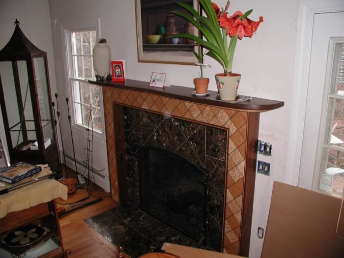

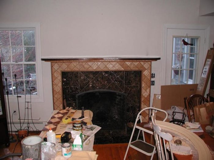

Here are a few pictures of our fireplace that we just dressed up – nothing too fancy. It was a standard red brick fireplace that we covered with brown marble. Then I made the fireplace surround and mantle with a combination of walnut and birdseye maple. What looks like tiles are actually squares of birdseye maple and what looks like grout are strips of walnut.

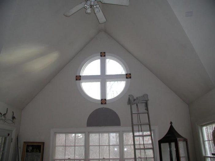

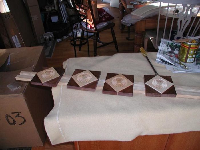

We also replaced a small half-round window with four quarter-round windows. I dressed up the standard Anderson rosettes with some walnut to tie them into the fireplace.

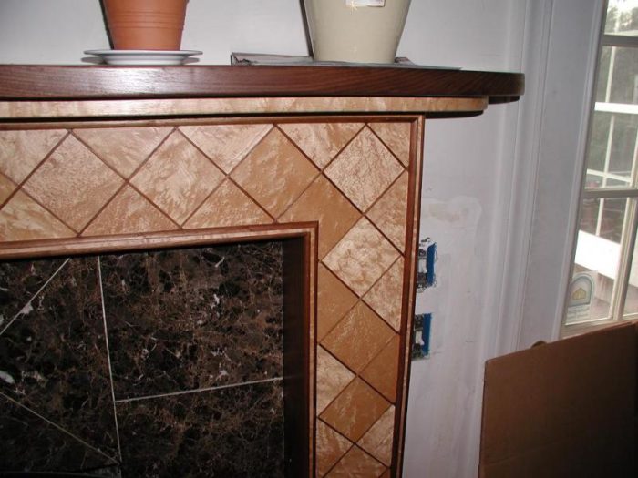

Whew, nicely done. How are the "grout" and "tiles" attached...and what are they attached to?...and when you go to the "bar" get 2 beers...you don't have to step on so much riff-raff, and you can still have a good time<G>nice to see your stuff back here. Don't worry, we can fix that later!
Luv seeing that kind of work!! I'd like to hear some more details about the methods and materials. It all looks excellent!ADH Carpentry & Woodwork
Thanks, guys! I wish I had taken pictures of the construction of the surround but I didn't. Oh well...
I used blocks on the inside of the walnut sides of the surround to attach them to nailers on the walls so that there are no nail holes on the outside. For the face behind the birdseye I used AC ply with a coat of sealer. I backsawed the birdseye from thich rough-cut stock and then planed it down to 3/8 inch thickness.
The trickiest part was coming up with a tile size and "grout" thickness that would result in the diamonds lining up correctly both horizontally and vertically. That was done with a combination of A**2 + B**2 = C**2 for the diamonds and trial and error for the grout.
I sealed the backsides of the tiles and then used formica cement to stick them in place and used titebond on the grout. So far so good. I found some nice thich birdseye and walnut at a wholesaler in New Hampshire that I used for the mantle.

That's pretty work. Shame there wasn't more room to get the switches in so they won't be tight up against the surround--but not much for curing that short of removing door structure.
Still looks nice. The rosettes are so very well executed. Only thing missing is the j-box for the light for the picture that so obviously wants to be over the fp . . . Occupational hazard of my occupation not being around (sorry Bubba)
Thanks, CapnMac. I couldn't move the switches over anymore because the studs to the right form a post for a second floor beam. I'll try to carve a faceplate for the switches that'll blend with the fp.
