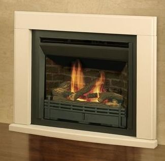

I’m trying to find something similar to the trim around the fireplace in the picture. It looks like some kind of stone but i’m not sure what kind. Searching the net has not resulted in anything useful, probably because i’m not using the correct search terms.
1. what would this trim be called ?
2. Is it likely to be sandstone ? maybe even a man-made product ?
3. If i can’t find a source and want to try making it myself, what would you use ? a mortar or grout with a pigment ? Perhaps someone can recommend a product that already exists to do this kind of stuff.

Can't really tell from the small photo, but it could be Corian or similar solid surface material. Of course, it could also be painted wood.

Hmmm, Corian..not a bad idea..and i can route it too. I might consider that.
In the high-resolution picture, the texture of the trim looks like sand. I don't think it's smooth like Corian or paint but it's hard to tell. The sand texture was my initial choice. Any idea if it could be a natural stone or more likely somethin man-made ?

If it's a sandy texture to the touch, then I doubt it's corian or other solid surface. Unless, of course, they etched it with sand blasting or something. But I'm guessing it's a natural material. I think sand stone would be a little darker, more of a tan or very light brown. It may be lime stone, but I wouldn't really describe that texture as sandy.

As far as the cap material used in the picture, it might also be a man-made sandstone like Haddonstone (http://www.haddonstone.com/shop/Product.asp?PG=FIREPLACES&SG=Fireplaces&PI=HF135)
http://www.mantelsdirect.com/stonefireplacemantelslp.html
Cast Stone?
You might try searching for "cast stone", tho this does look more like a corian material. Very hard to tell without a closeup.
Searching for "cast stone" is bringing up what i'm looking for. thanks
