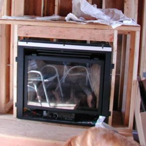

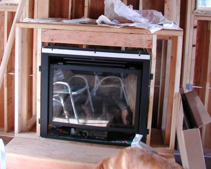

        I do not believe the code is the same, I believe it applies only to an open hearth style fireplaces.  And yes Andy I am following the manufacturers directions for proper installation.  I should have said in my original post that this was for a zero clearance gas fireplace.  I attached a picture of the box frame and fireplace for better explanation.If it wasn't for bad luck I wouldn't have Any!
        1. AndyEngel | Dec 10, 2003 05:05pm | #13
          The code I quoted was for mantels and such. I'm pretty sure that for the installation of zero-clearance units like yours, the code defers to the manufacturer's instructions. You should check those instructions for trim specs, too. In a former life, mantels were a good part of my business, so I'm not without experience in these waters. In NJ, at least, the inspectors wanted the manufacturer's instructions followed.Andy Engel, The Former Accidental Moderator
          1. jeffwoodwork | Dec 10, 2003 07:49pm | #14
            The last zero clearance insert I did the Manufacturer info was for mantels 1:1.  So every 1" out it had to be 1" up from the actual body of insert.  I don't recall but the sides are different.
