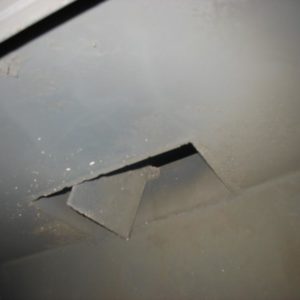

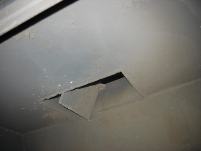

Hi Guys,

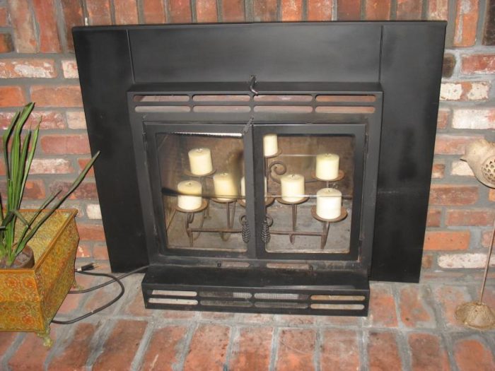

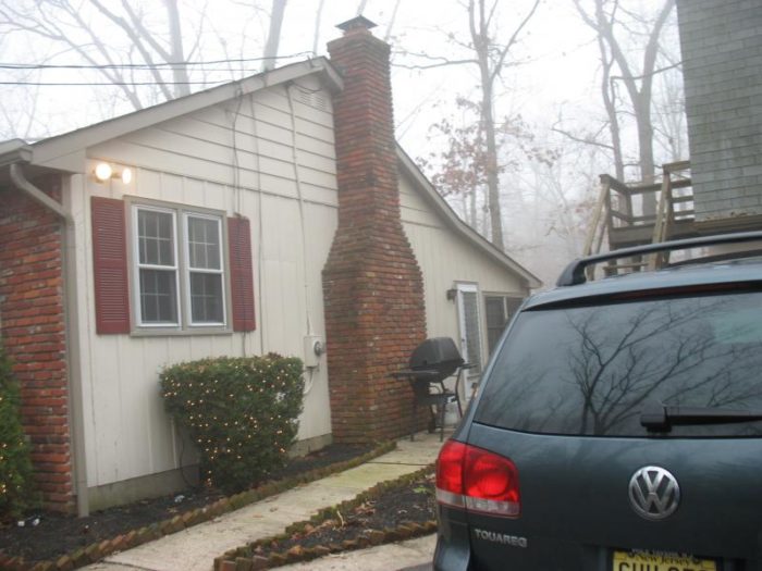

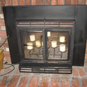

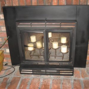

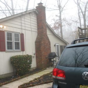

 You all seem to have the answers for everything!!! My fireplace lets smoke inside the house.(not alot, but enough to rain havic). I am sending of few pictures. Maybe this can help you solve my problem.
please note: When I light the fire it eventually dies out and smokes, I open the vents on the door to feed the fire and it does not help. Yes I open a window Too.
Thank you and PLEASE HELP (the wifes getting antsie)

  4. Lansdown | Nov 29, 2006 11:34pm | #5
    First of all I think that is meant for firewood not candles ;-)
      CapnMac | Nov 30, 2006 12:07am | #8
      Depends, don't it?  On whether those are IRC or CABO rated candles <g> . . . Occupational hazard of my occupation not being around (sorry Bubba)

          CapnMac | Nov 30, 2006 07:12pm | #21
          Get serious guys!!! I have to get this thing working soon!!!!!!
          Oh, you're still new--this, occasionally, is as serious as we take things, sometimes.
          That looks like a new front, is it jsut a front, or an entire firebox unit?

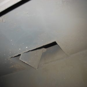

          That damper looks suspiciously small--like a gas-only sized opening not modified to "wood or gas" dimensions (not that I've found where somebody listened to the sage wisdom of a big box employee or anything <sigh>).
          Is your unit drawing outside air for combustion, or inside air?
          I'm in this reply, so I can't go back to the original post--is the problem smoke in the house, or outside, that is the issue.  Outside smoke is often an issue not of the exhaust of combustion products so much as condensing humidity becoming fog/clouds (that's because the weather "for a fire"--versus just for heat-- often contributes to that).
          If it's smoking in the house until the flue warms, then it could be (I'm just a guess on the internet, after all) that the proportions of the chimney, height & flue area, are not matched to the firebox/insert dimensions.  That gets you back to asking a local sweep, who might could tell you all you need is a smaller flue (more acceleration); or outside air for combustion, or some such.Occupational hazard of my occupation not being around (sorry Bubba)
            IMERC | Nov 30, 2006 07:19pm | #22
            inadequate make up air and up air flow..
            the damper is a choke point...
            fire is burning too cold..
            loucarabasi | Dec 01, 2006 03:04am | #26
            Capnmac, smokes coming in the house,  cumbustion air is coming from inside the house.
            Thanx, Lou

    How high is that chimmey?
    It looks like it might only be 2ft over the peak, if that much.
    Don't remember the clearance, but that does not seem like much.
      loucarabasi | Dec 01, 2006 03:00am | #25
      The height is around one foot above the ridge?
      -Lou
        IMERC | Dec 01, 2006 03:09am | #27
        add a stack to put it 2' or more above the ridge..

          OK lOu, now that I have seen pictures, I think I know what your problem is.What's the answer worth to ya?just kidding.first thing, the chimney is not high enough, but that would only be a problem on days when you have a low pressure system or the wind is from the right direction in some locales.The greater problem is that this is not a fireplace you are showing us. It is an insert. There are several things that can be wrong with an insert installation...
          one is that the flue of the original chimney is sized too large for it. An inser toperates much like a wood stove and requires far less air than a fully open fronted frireplace. Put a unit requiring a 6" flue into a 12x12" flue and it will not draw well because it does not release enough exhaust air and heat to get the larger column of air above it moving. A temporary fix for that problem is to get a rip roaring fir of paper, cardboard, and kindling going to heat up the chimney at first, before tempering the fire for a longer burn. Without doing this, the mass of masonry is cooling the exhaust air faster than it is rising, and the cooled exhaust wants to fall again before clearing the top. The long term fix is to have a liner connected that will keep a proper size all the way up.Another possible problem is not one I can confirm with the three photos thus far. The type of insert you have shouild be connected to the old masonry flue via direct connect so no smoke is permitted to escape into the house. This is a difficult connection to do, and I would guess that a good 40% of trhese were not done right. if this is an older unit, it couled also have a rusted connector that is spilling exhaust gasses into the house. This is much more than an inconvenience, it is downright dangerous as it could be adding lethal quantities of carbon mopnoxide into your living environment.The third thing that comes to mind is that if this has been installed and used for a long time, there could be a buildup of creosote in the flue reducing the hole to almost nothing. That is an extreme case, but I have seen people manage to gum up a flue to finger sized openning in as little as a couple of months by burning green wood slowly.Finally, the interior design of this unit is not an efficient one. It is cheaply built with no smoke rise space allowed. There is a totally flat top except for the flue damper hole. it should be tapered up to that flue or have a smoke flap in the front at the least. I would expect it to smoke moderately at most times just due to the design of the box. do not use the fan until the whole unit and flue are well warmed up.There is my free advice on the smoke problem.
          You are on your own with your wife. Good luck on both counts.;)

    By the look/age of the stove, I'd bet that your seals aroung the door and glass are shot.
    Also, There are alot of these types of stoves that vent to the chimney without any pipe and they will backdraft back into the house, specially if the fire starts to cool down, or at the start when the chimney doesn't have enough heat to draw the smoke up and out.
    I'd look into both of these, along with the other suggestion about a blockage.

    You have an exterior brick chimney, which is a huge cold sink, and detrimental to the start of a good updraft, or the maintenance of an updraft if the fire is allowed to get too small. A fire set in a cold fireplace and flue will easily stall out as is happening to you.

    Lou I'm with hartman,
    The top of the chimney is supposed to be a minimum of 3 foot over the highest point. Per building code.
    First I'd knock out the critters as suggested. (although the fireplace looks new)
    Warm the flue with a section of the newspaperlit and held high. and see if it draws. a lit match outside the doors would tell you.
    Last step would be adding on a section of flue to the top and recapping it.

    Last thought is the damper. check and see it operates fully. If it is one of the energy efficient top-of-the-flue dampers it could be messed up and not opening properly. Even a standard top-of-the-firebox damper could be misadjusted so it doesn't open fully and draw well or you could have something on the smoke shelf behind the damper. (I once had a duck fall down my chimney as well as a blackbird flew in there too.)
