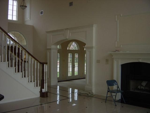

A pic is worth something...I can not remember what, but I think it saves on typing time. Thanks Irfanview, these were originally huge, making it tough for the dialups.
These were painted, but could have been done and stained.

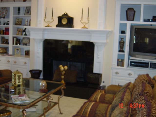

We found the corbels on the Raia Fireplace at an antiques store. They had fluted shafts to match the other fluted lumber.
