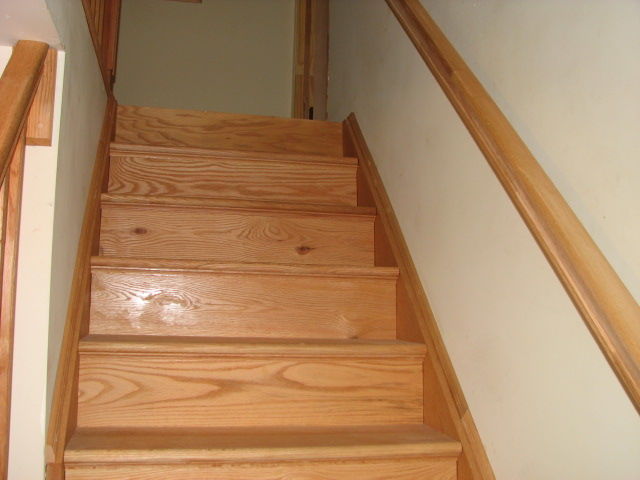

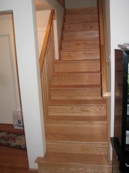

Just finished my first attempt at an onsite open skirt stain grade stair case. I learned a lot on this and cleint was very happy with results. Fit was VERY tight, just making code on clearance. I milled everything except treads and handrail. I was very happy to have read the staircase book recently published by Taunton. Hope to do more after this one… client wanted to put finish on himself. I wasn’t thrilled, but what can I say?

what is the riser hieght?, The stair looks kind of steep.
It was right at maximum allowed height in this area. It was definitely on the high side. I don't have my notes in front of me, so I don't want to guess what I used. Client was an electrician, but had done some building. Did want to tackle the stairs, but signed off on the rise and run...making sure they were within local codes. It was real pain getting them to fit in a VERY tight space. Head room was exactly 6"8'. No room to spare."The nearest thing to eternal life we will ever see on this earth is a governmental program" -Ronald Reagan
Okay, I went back to my notes. Here are the numbers I had to work with:
actual run: 105"
rise: 105 1/4unit rise: 8.1"
unit run: 8.75"We just made the head clearance with that...did I mention it was a very small house!!"The nearest thing to eternal life we will ever see on this earth is a governmental program" -Ronald Reagan

Did you prefab the staircase, or stick-build it in place?
had to build it in place...residence was too small to bring in finished product, and they didn't ask me in time to lower in place before framing, as that was the only way there was room to install completed staircase."The nearest thing to eternal life we will ever see on this earth is a governmental program" -Ronald Reagan

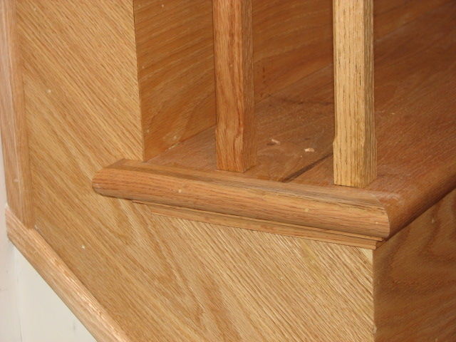

How did you cut the open skirts?
Gord
carried marks over from stringer, checking for plumb and level; set the old Bosch worm drive on 45 degrees and cut them in a room WAY too dark by hand. Finished cuts by hand with hand saw. More control than with a jigsaw."The nearest thing to eternal life we will ever see on this earth is a governmental program" -Ronald Reagan
You're pretty handy with that circular saw. Its been a while since I did one that way. I remember using table saws for the cut. Right tilting saw for left hand skirts, Left tilting saw for right hand skirts.

now THAT's impressive. I generally do not take my Bosch slider on the job, but it might have made sense looking at what you're doing! That will be on the agenda on the next one, to be sure. Thanks."The nearest thing to eternal life we will ever see on this earth is a governmental program" -Ronald Reagan
thank you for the kind words. I spent a fair amount of time watching some of Gary Katz's advanced techinques dvd. I'm always open to trying to learn something new every day. BTW: He's going to be in my area at the end of Sept. and I can't wait to go watch his demonstration."The nearest thing to eternal life we will ever see on this earth is a governmental program" -Ronald Reagan
