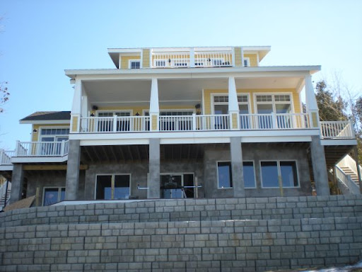

It goes on the lower unfinished ceiling I know it not a good shot, its the only thing I had as I wasnt really taking a picture of that ceiling, I was hoping it would give a rough idea.

Obviously if the max run is 18' or under. Looks less than that looking at the picture. You could also sheath the joists (1/2) ply, and nail to that, with an appropriate adhesive. If the material is NOT going to be painted any face nailing holes can be filled with Crayola Crayon White,
