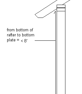

 Since the slab on my addition was not  square I had to adjust the bottom plates of my walls accordingly. In some areas the wall sheathing will have to be cut down since the bottom plate is not flush with the outer edge of the slab and I can’t over hang the sheathing past the slab. Should I use some kind of flashing on the lower edge of the wall sheathing? I added a crude sketch to show what I’m talking about.
  1. frammer52 | Mar 27, 2009 10:03pm | #1
    Please tell me you didn't hold the bottom plate in more than 1/2".
    1. blownonfuel | Mar 27, 2009 10:21pm | #2
      I had no choice in some areas. The slab bowed out in some sections. My bottom plates would have looked like snakes if I lined it up with the slab.
      1. frammer52 | Mar 27, 2009 10:26pm | #3
        Can you cut the slab back?
        1. blownonfuel | Mar 27, 2009 10:35pm | #4
          Possibly, that would take a lot of cutting though.
          1. frammer52 | Mar 27, 2009 10:46pm | #5
            Then I would fashion a pice of aluminun flashing, simular to window flashing.

  2. Snort | Mar 28, 2009 12:27am | #9
    How bad is it? You may be able to run bitchythane door and window tape and cover that with galvanized door/window head flashing?

          3. Snort | Mar 29, 2009 01:45am | #17
            In that situation, I might caulk the sill/foundation joint (I don't think I saw sill sealer) run some window wrap about 1/4" over the foundation top to isolate the metal from the seement, sheath 1/2" above the foundation, then the appropriate galvanized head or zee flashing. I can get head flashing in different projections. What you want is something that doesn't touch the cementitious stuff. Then, housewrap over the flashing.http://www.tvwsolar.com
