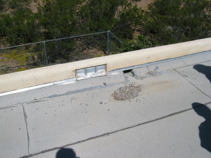

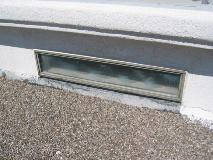

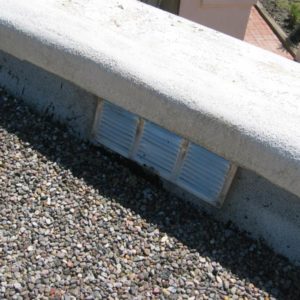

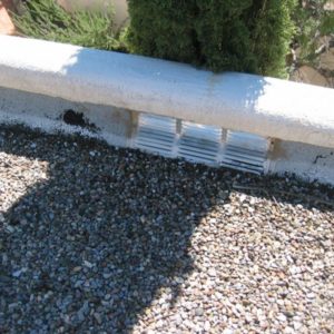

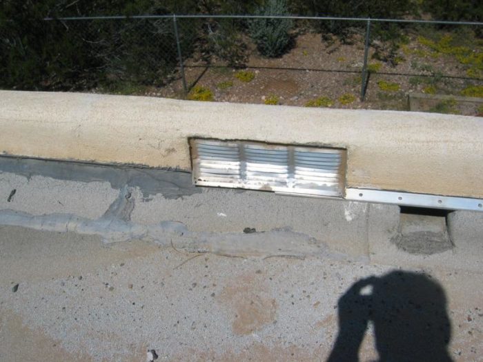

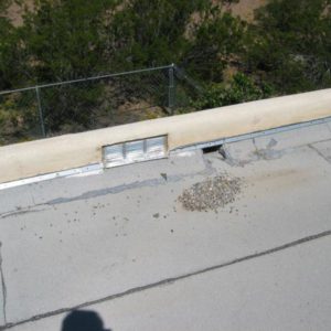

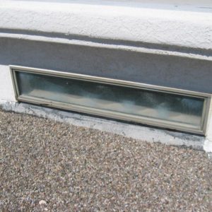

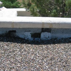

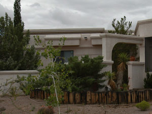

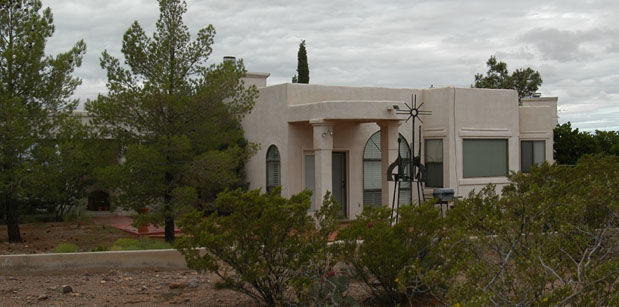

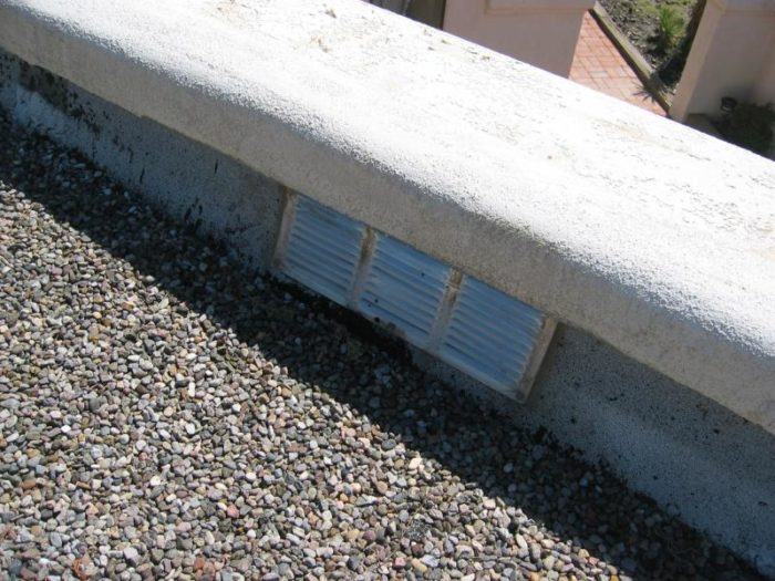

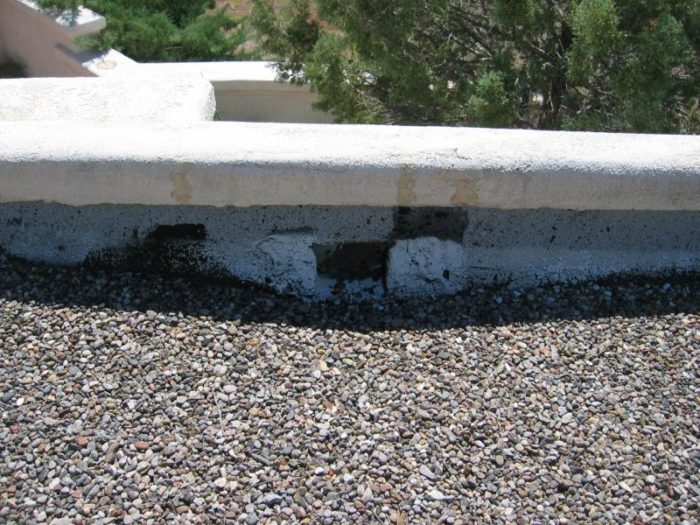

    PhillipB | Oct 26, 2006 08:47pm | #24

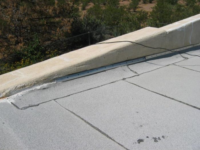

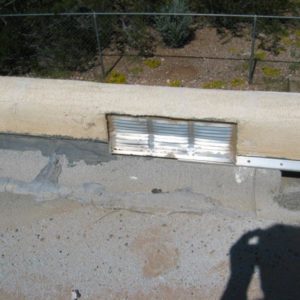

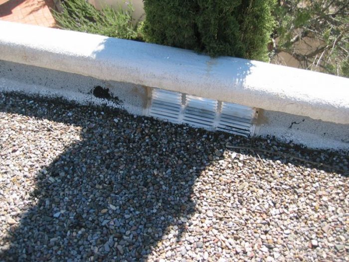

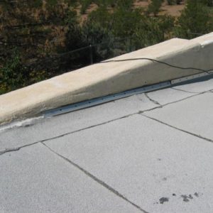

    Gentlemen,
    Here are the images as promised.
    I'll upload them and then all of you can make your assessments.
    They all clearly show the ridiculous vents which I believe are the cause of most if not all the water that gets into the house. In addition, you can see what roofing material is on the roof. The roof images which lack gravel are those areas which have been previously re-roofed. The worker's simply dumped the gravel into the backyard rather than onto the drive where it would have been more useful. This took place before my time, else they would have done what they were supposed to have done in the first place.
    The "Roof" image shows the roof sloping upwards towards the top of the clerestory window(s) shown in the "Window" image. The area above the window is the highest point of the roof area. Unfortuately, I do not have an image which would have shown this much clearer. There are three (3) clerestory windows and all have to be replaced prior to the roof replacement. All have water between the panes. Apparently the inert gas has long since escaped. We have several windows that will need to be replaced.
    Thanks for all your help and suggestions.
    Phillip
    1. theslateman | Oct 26, 2006 10:59pm | #25
      That's not a roof for someone to do who isn't well versed in both the materials being used and the techniques required to make that water tight.
      There are some fairly tricky spots there which will require excellent skills for a first class job.
      Maybe you need a consultant to write specs for 3 or 4 bidders to bid on-apples to apples that way.
        PhillipB | Oct 26, 2006 11:13pm | #27
        This could well be why this roof has been plagued with leaking for years. The roof above the master bedroom has been replaced three (3) times and it still leaks.Could you be a bit more specif about the "tricky" parts of the roof you are referring to?Again, I believe that the major problem is the parapet vents which will be replaced with conventional roof vents. The lathe or what ever the proper terms is for the metal strip that holds the roof material to the parapet walls has screws which can leak water as well. They should have been caulked over for the git-go.As to your comment about a consultant, we are working with an architect who already got us two quotes - $20K for Duro-Last and $10k for a regular roof. We will not go with a regular roof, and the $20k is a bit stiff. That is the reason I began this thread.I appreciate your comments

      Heck | Oct 26, 2006 11:03pm | #26
      Wow.You've got some work to do. You already know what you have to do with those vents.
      Would be nice to have bigger scuppers, but that would be difficult to do now, unless it's possible to make the vents into scuppers?
      The newer part is modified bitumen, will not handle ponding.
      I still suggest elastomeric, but perhaps those here with more roofing experience will be along to advise you._______________________________________________________________

    3. vintage1 | Oct 27, 2006 12:45am | #31
      Phillip,
      Thanks for posting the photos of your roof.
      FWIW, I will offer you my comments.
      First, according to what I see in the photos, your roof is nowhere near flat.  It appears to have sufficient slope to drain even the gully washers you reported earlier in the year. For example, a commercial warehouse roof that might be 100,000 Sq Ft. can be adequately drained with 1/4" per foot slope.  Your roof appears to have more than that.  This is good news, It allows several options for reroofing.
      My assessment is that the existing roof is poorly detailed.  From what I see in the pic's, Flashings are poorly terminated and their height is insufficient.  I also see a lot of roof cement used as repair material.  Typically, this is a short term fix.  I only assume that the balance of the roof is less than optimum.
      I am uncertain as to what the parapet vents do.  I agree with eliminating them, but what are they venting?  Why are they there in the first place?
      In my opinion, this is not a project to undertake if you have never installed a low-slope roof before.
       I know that people have recommended Seal O Flex, or other fiber reinforced elastomeric coatings as your solution, but I personally would not be comfortable with this on my entire roof.
      I agree with another post who recommended hiring a roofing consultant.  They are professionals who can help develop specifications to meet the design criteria for your project.  If this is an avenue you want to pursue, you might Google RCI (roof consultants institute) to find one in your area.
      I hope this helps.  I have some background in low slope roofing, if you have additional questions, I would be happy to reply.
      By the way, what is the existing roof deck?
        PhillipB | Oct 27, 2006 01:54am | #33
        vintage1,"according to what I see in the photos, your roof is nowhere near flat. "
        When you formed that opinion, you must have been looking at the "Roof" photograph. I need to explain. I wish I had a photo of this but I'll try my best.If you look at the "Window" photo you're seeing one of three clerestory windows. The section of the roof behind these clerestory windows slopes up from the actual flat part of the roof and rises over these clerestory windows. This raised section is actually an "L" by design. The clerestory windows are on the long side of the "L". The short section of the "L" has no window in it. The short side simply tapers back down to the horizontal or flat section of the roof. In other words, the roof slopes up to go over the clerestory windows. The interior ceiling parallels the roof. I hope this makes sense to you. I really wish I had a photo that was taken from the roof, but I don't. I've attached another image which may help a little. If you look to the right of the tall evergreens in the "Clerestory Windows Header" photo, the highest horizontal section that you see is the same header that you see in the "Window" photo above the clerestory window. I hope this helps.I'll get this back to you so you can take another look. I do want to say that I was hoping to do this repair myself in the Spring, but from what most of you are saying, this is out of my league. I respect what each of you has to say and I mean that.Now, to embarrass myself further, I'm not sure what you mean by "the existing roof deck". If you're asking what's below the roofing material then I will say that I believe it is plywood (PW). That is the norm in this area. I had another home once in which the contractor used 3/8" PW for the decking. I can almost read through 3/8" PW. At that time, it was actually legal to use it. Does NM have good lobbyist's or what. I was outraged because the AC was on the roof and you had to be very careful where you walked. I used to laugh thinking that I needed a ladder to get up, but I may not need it to get down.
        1. Piffin | Oct 28, 2006 02:01am | #39
          Hello again.From what I have seen in those photos, the vents are the very worst problem. Those were never intended to be used in this manner, then they were installed poorly and way too close to the roof surface, some right down on the roof.Also, you are right that the roof is poorly detailed and bad woirkmanshipo, the scuppers are way too samll. I would bet that they allow water to back up during a heavy downpour and then runs in the vents.The termination bars are also a poor choice and installed too low.EPDM is the right material and no matter what material is used, this roof haas to come off and the scuppers enlarged.
            PhillipB | Oct 28, 2006 03:52am | #44
            Piffin,Thank you, sir, for you comments.No one that has seen these "vents" has a clue as to why they were made that way. In my mind they are more like funnels inviting the water into the house. Stupid.And, yes, many are very close to the roof surface. Before we left there, I did cover up the low ones in an attempt to prevent rain from getting in. It was only a temporary fix until we can figure out what we are going to do. I really have no idea just how big scuppers are supposed to be, but you are not the first to make that comment. This roof appears to be exactly how a really bad roofing job should be done. Not to mention the great vent design. We have an architect friend who was baffled when he saw them for the first time. He had no idea why they were done that way.The termination bars are all very loose and the screws used are too short to do any good. IMO, the should all have been caulked over when they finished installing them. The Duro-Last contractor said he would use them only as insurance. He would actually take the Duro-Last membrane over the parapet walls which is much better than what we now have.I also agree that the old roof has to come off. The D-L contractor did not want to remove the old roof. I have a problem with that. I believe that it has to come off and be repaired properly once and for all. Hopefully, we can get by until Spring. The home is unoccupied so that's not a problem. As I've said earlier, we have pans and buckets about the interior which security folks keeping an eye on things.Thanks again for your comments.

          7. Piffin | Oct 28, 2006 03:48am | #43
            What was said earlier about having a consuiltant or architect write specs was good advice.If all your archy did was review offerings by two different roofers proposing to do the work with a product and method that the roofer speced, that was an entirely different thing.What you do is have a person well qualified in roofing write up specifications for the kind of roof you want - let's say you want EPDM. the manufacturers reps can sometimes help you with this, tho it is less likely for a residential roof - so the spec sheet lists all the things that must be done to create a good roof with what sort of material installed according to this and that detail.Then you present it for bids to the interested roofing comnpanies. If your community is small, there are few choices, but in larger cities, you might attract several interested parties.
            PhillipB | Oct 28, 2006 04:07am | #45
            Piffin,All we did was have or architect make the calls. One contractor wanted to do foam or a conventional roof. The other contractor only did commercial Duro-Last work but he was talked into coming over to look at our house. Our architect prefers and believes in the Duro-Last roof.The town the house is in is about 70K in population. Too small perhaps, to find the type of consultant that you are referring to. I will ask our architect about that. We're good friends and I don't have to worry about what I say, He does have our interests at heart. I will give him a call tomorrow about this.What you say about a qualified roofing consultant makes perfect sense. He knows roofing and can spec it out according to what we want. The selected roofer has to agree to the spec's else he doesn't get the work. It's all in the details. This is very good advice.Once again, thanks for providing very valuable information.Regards,
            Phillip
          9. Piffin | Oct 28, 2006 04:29am | #46
            I don't know the Dura-last product, but doing the parrapet wallls to the top would be the way I'd handle this roof too, with any product I am familiar with

            PhillipB | Oct 28, 2006 06:52am | #48
            The D-L contractor said he would actually go over the parapet wall with the membrane but I'm not so sure how that would look from the outside. We haven't got that far yet, so we still have a lot to chat about.The D-L contactor made several other statements:
            (1) He would guarantee the roof for 5-years. He said they had that much faith in the membrane material and their workmanship;(2) He said they were finding out that the price of a home with a D-L roof would actually go up in value. I thought to myself, sure, but first you have to overcome the $20K you just dropped for the roof;(3) He said that this roof would be maintenance free. Compared to a conventional roof, that may be true;(4) He said that because the membrane was pure white, it would also help to cool off the house. This would be very good since that part of the Southwest is so hot during the summer months.I know I'm sounding like a D-L dealer, but they do have a lot going for them. I'd rather be able to do this myself, but going on what most of you have said, this is a job for the pro's to do. I respect all your opinions and expertise which is why I began this thread to begin with.Regards.

          15. Piffin | Oct 28, 2006 03:35pm | #52
            On the parapet walls, if appearnce is an issue, they can be capped with a sheet metal flashing that is made to fit
