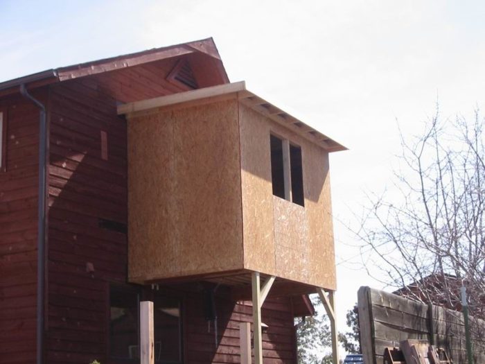

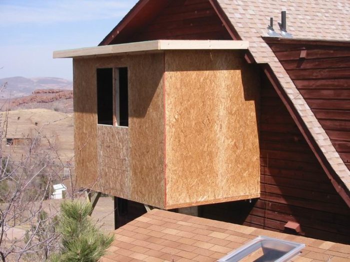

Attached are pics of a small addition that I’ve built for a client.
The pitch of the roof is 1/4″ per foot over 8′-6″.   Nearly flat.
Heres the question: How much should a rubber membrane roof cost?
The only roofer that has responded diligently, has given a quote of $2000.00 for the rubber roof.  The county requires a class A or B roof system.
The roof deck measures 9’6″ by 13′-0″.  That’s about $120/sf.
Is that the going rate for a rubber roof system?
Or is the roofing contractor going for a home run with my client?
FYI – Per my agreement with the HO, it is specifically not my responsibility to install roofing, or even qualify roofing bids, or solicit roofing bids.  However, after hearing about his trials in finding a roofer, I am wondering membrane roofs really cost this much.

      I'd be adding more than you for the flashing, because that detail where the front red fascia intersects it is tricky, and this place looks pretty rough and rugged on the siding/trim details. I'd have to take some siding off to get flashing in right and I don't think that stuff will be salvageable for replacement. Probably would spend more time on flashing than on installing the rubber.The client made a major mistake gong with a flat roof on this. It really uglifies the house, while making the roof more expensive.First glance makes two grand sound high, but maybe not - no t knowing right where it is.
      1. lettusbee | Mar 24, 2009 01:04am | #7
        Piffin, I agree with all of your points, and made some of the same arguments in the design phase.
        One thing though, and the pics are deceptive here, all siding has been cut back by more than enough for the roof wall intersection.   The roofers all also know that I will be there for any wood removal necessary.  (I am doing more work in other parts of the house while the other trades are working on the addition)
        PS, there are other window openings to be cut out when the windows show up.  That should help with the looks. I hope.
