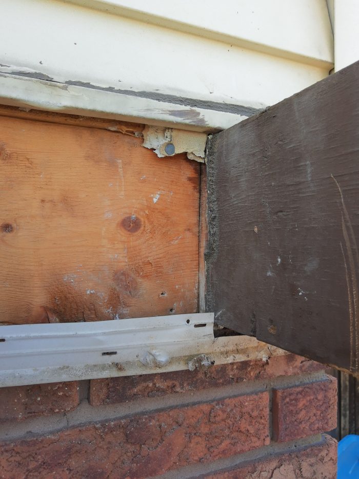

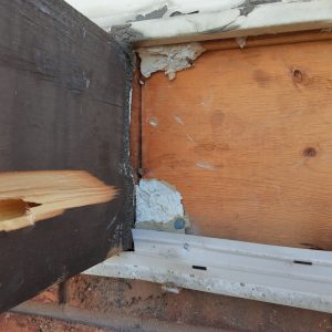

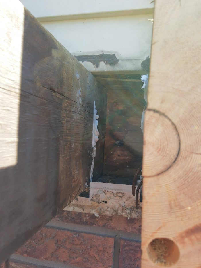

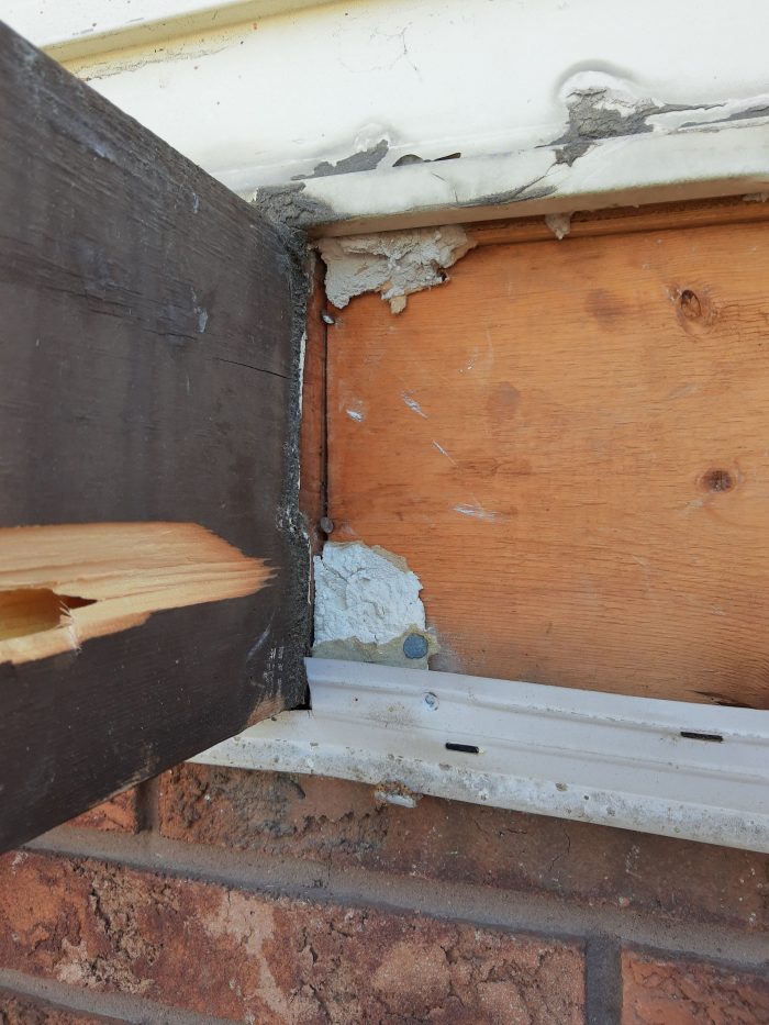

  5. melde | Mar 30, 2021 11:07am | #9
    Hey, We are in a similar situation.
    I plan on doing Nic recommendation above. The question is what tool do you use to cut back the deck joist nearly flush?

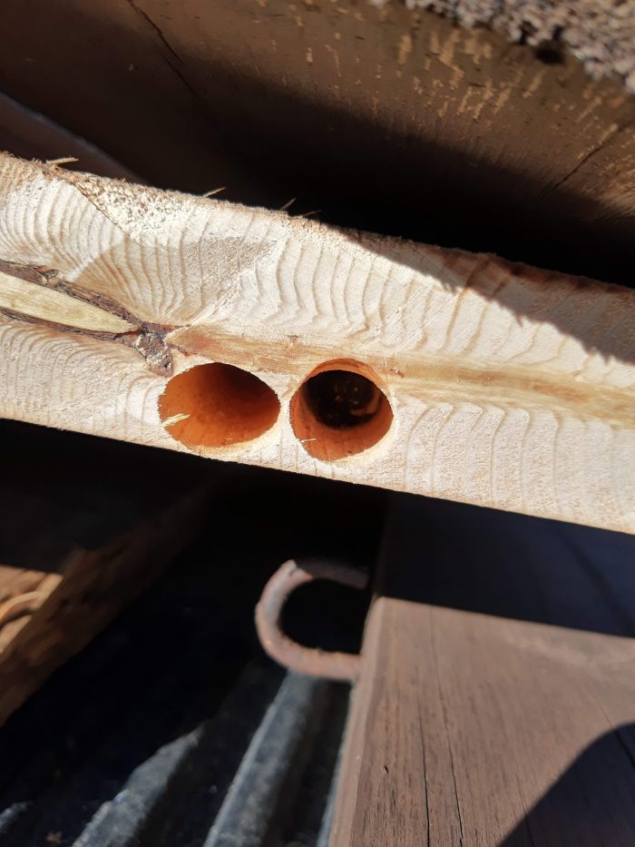

    Look at the hole from bee borings

    2. Ryeman11 | May 26, 2021 06:55pm | #12
      Hey Melde,
      We are currently in the same situation. Did you find a way to cut the floor joists back 2" ~, so the band joist would sit flush with the house? Also how did you secure the band Joist and did you add blocking behind it?
