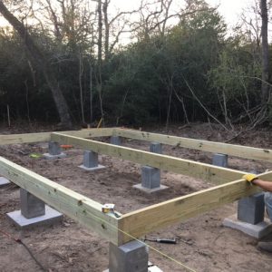

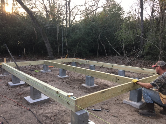

Hello, I am building a 12×24 shed/cabin. I have installed three beams setting on concrete block peirs running the length of the cabin. Beams are made of doubled 2×8 treated lumber and all three tied together with single 2×8 on ends and one in the center. My original plan was to set 2×6 floor joist on top of the beams but after seeing how high that would stand, I was wondering if it would be just as strong of a subfloor if I butted the joist  against the inside of the beams and use joist hangers.

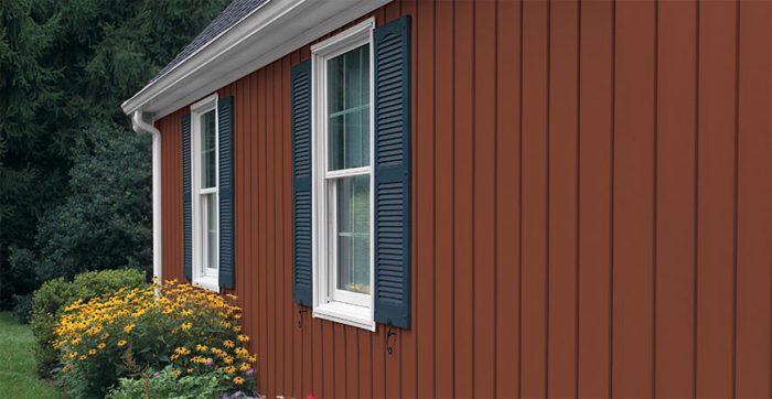

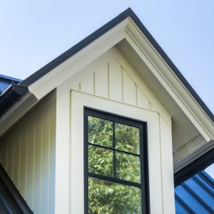

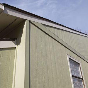

        LP does make 9' Smartside panels. You might find them, or be able to order them, from a lumber yard, not the big box kind. If it was me I'd lower the panel so it covered a few inches below the subfloor so it completely sealed the joint between wall and PT sill. If the soffit didn't hide the top gap I would use a frieze board, the same LP Smartside, at the top. You would shim out the trim piece to overlap the siding. It would look just like the frieze trim on any house. I hope these pictures give you a sense of what I mean. The frieze can be any height you want, but you'd want it to look proportional to the scale of the cabin.

          I totally understand now after seeing some pics of frieze boards. Before I have just used 1x2 to cover up that joint but now I see I can use pretty much any size and it looks good. I think between a frieze board and the rafter tails being below the top of the walls, 8 foot sheets will probably be enough. Thank you again for your expertise. I have built a few small sheds before just trying to do this one the correct way.

    1. eddo234 | Feb 04, 2022 06:39pm | #8
      Based on his photo I’d say he’s more than fine. ;-)
