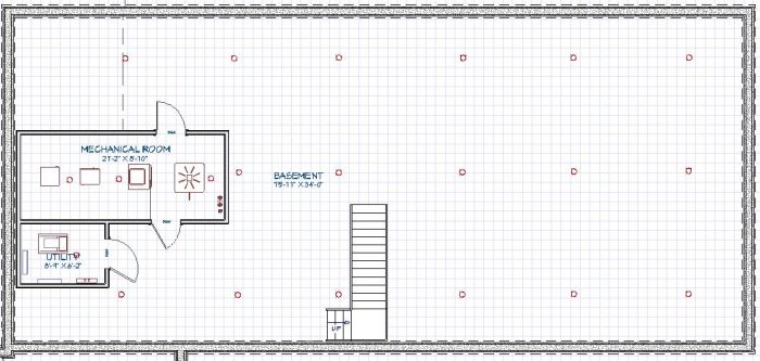

    I've included a guess at what I'll need in the basement. The circles are ligh bulbs, I don't have any columns yet.
      unclemike42 | Feb 15, 2022 06:36pm | #9
      The roof trusses can also be designed for intermediate supports, like an intermediate load bearing wall. (in addition to design that transfers loads at the outside walls only)
      Roof trusses are a little easier because no one complains much if the roof moves a bit when you walk on it.
