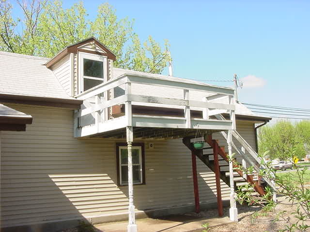

My boss bought this rental property a couple of weeks ago.It sits across the hiway from the shop so when my job for today got cancelled he told me to go over and get it ready to fix up. I took a helper and we hauled off four truck loads, of carpet and other crap. When we got done this is what we had. The guy was obviously suffering from some sort of mental problems or was just a total loser. he had added an upstairs to the house but didn’t bring the ceiling joists up to code. They are one by sixes, the upstairs porch supports are supported by decorative porch posts. Here I’ll just let you guys look and laugh. The picture of the floor with the hole in it is upstairs the decking of choice is that cardboard looking stuff called pressed wood.

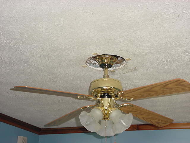

By the way, I really like that recessed fan, nice detail, and those "colums" very sweet looking, specialy the way they don't quite even sit right under the deck

LOL, he had a goof ring sitting in the floor but it woiuldn't look to good with the rest of it recessed.Who Dares Wins.

That looks like a budget problem more than a mental problem. WHomever lived there didn't have the cash to do it right or they were spending it at the casino. Spooky. If you dump enough $ into it to make it look and be solid you'll still have that dinky overhang on the gables.

I don't know why everyone is calling that thing a deck or porch. It is a fire escape. But most fire escapes are intended as a SAFE means of egress..
I was thinking along the lines of kindling but if you want to call it a fire escape I guess you can. LOL Who Dares Wins.
It's displacing air in the same place that a fire escape would do same.
Some folks call anything that displaces water a boat.

Man Gunner? If those posts weren't under the stair stringers to take out the bounce the weight of the stairs alone could topple that deck. The footing/patio looks sufficient. Do me a favor, put a diagonal sway brace from corner to corner under that deck before you go out on it.
