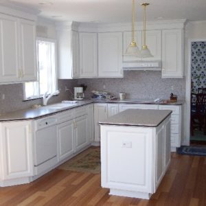

  2. calvin | Jun 19, 2003 02:11pm | #2
    Here's a big fill/crown on top of Frameless.
