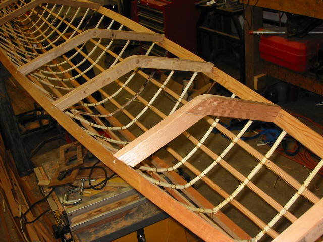

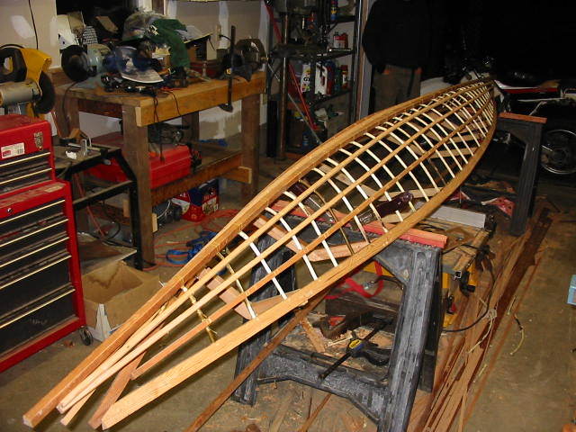

My son and a friend have been working on this for about 8 days..
Total costs of wood materials was $14.00 (salvage DF from a recycle store, willow limbs, some scrap oak pieces.
No nails, screw or glue. (Except for glue used to make 1x 2 out of 1 x 1 stock for the gunnels, and to make the deck rib connections at the peaks.)

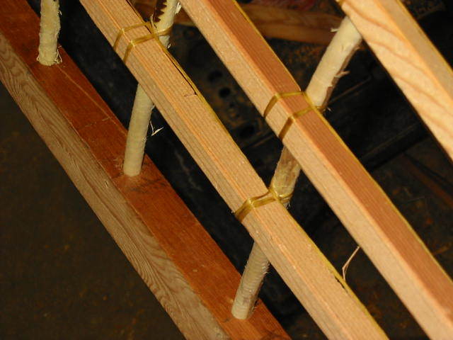

Every connection is either mortised and doweled or lashed together.
Skin will be ballistic nylon coated with urethane.
It is being built out of scaled drawings of Aleut Indian kayaks.
Not a bad framing job .

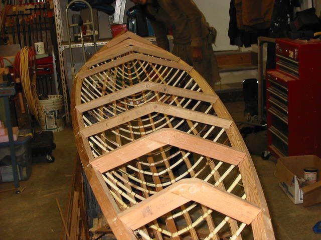

vocteach, That I will have to ask my son. He is gone for a few days so I will ask him when he returns. Here are some pics of the frame complete except for the cowling framework.

urethane. it is sewn on with nylon string.the frame was lashed together using artificial sinew,
which is available at leather-working shops. it is
fine nylon strands which have been laid together and
waxed rather than being braided or twisted together,
so it has near zero friction. you can build the frame out of almost any material,

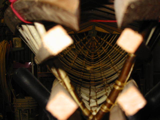

He is working on the fabric cover as I post this. Here are some pics. This is a different frame then pictured earlier, his cohort got the one I pictured earlier , then the two of them helped six other people build frames last week as well as built this one for him.
