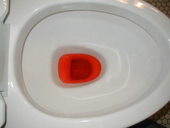

Well I just got home and measured the water spot size. Mine measures 6" by 4.25". To get the water to be 4.5" it would have to be about 1/2" higher than it is now.
Check out the attached pic. To me it looks like the water should go to the ridge in the bowl above where it is now.

Anyway, that waterspot does look kind of low to me, but it seems like that would be dictated by the high spot on the trap- is that adjustable in this design, or is it cast in porcelain like on most toilets? I wouldn't think that the casting would be totally wrong.

Went to the terry love forums and even signed up. A bunch of folks have the Aquia there and they all were concerned about how small the water spot is. They all say it works fine though. We've had the toilet installed for four days now and we are both still afraid to use it...
Tech help says nope no way to adjust the water spot size its a function of the design of the trap. So there you have it I guess.

I have a client that has 3 to the Totos in his place. The "water spot" looks just like yours and they really do work well with that small of a "water spot". One thing to remember is that if you have to turn the water off to the house for some reason in the future, you need to turn the water off at the toilets before turning the house water back on, then turn on the toilets. I don't know why, but we go through this every time we do something else at this house. Lots of projects there of the past few years.
I like a low water spot. Less chance of splashback and overflow. What kind of colorant did you use in your toilet to make it bright red?
I just used a couple of drops of food coloring so that it would show up on the picture.
