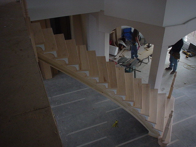

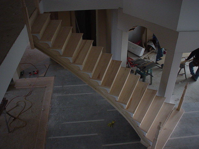

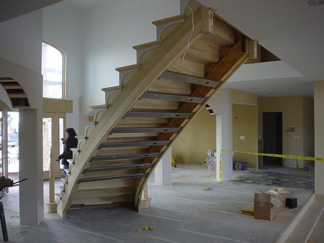

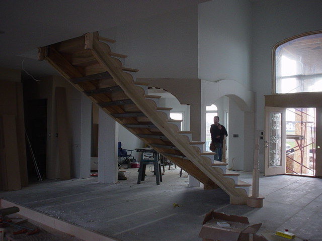

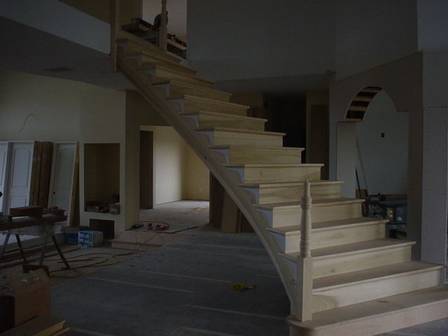

I just set this freestanding maple stairway today. It will have painted stringers..risers…riser brackets…and balusters. The newels, rail and treads are in maple
This took 8 guys to lift it up to its landing. You can see the steel studs I use for the plastered belly.
Stan-Nice work as usual. What thickness are the stringers and do you get any bounce? Thanks
greg in Connecticut
Greg: Thanks.. The stringers are 17 inches wide and 1.5 inches thick. Inside these stringers I have glued up eight layers of 3/8 plywood that is eight inches wide. Kind of a curved internal beam 3 in. x 8 in. It is very stiff,,but I am going to box in the first 4 treads...mainly because the owners want the look. This will make it even stronger....though I dont feel it is necessary to do so for strength.

Kestrel: If you want to lighten...go ahead....I should figure my camera out a little better.
Hi Stan,
Here they are. They are beautiful.
