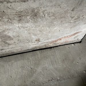

      I don't know much about why they installed the French drain. The info I have is that there was seepage- no idea if down the basement walls or a high water table. I have no idea who did the work- no permit pulled. Maybe to be on the safe side, I don't fill in that gap? I added a couple of pics

        Looks to me like that gap was left on purpose. Very deliberate. Hints that the issue was water running down the wall.
        You also do not know if the perimeter drain was installed allowing a path for gasses to freely flow from under the slab or wall or not. Is there a sump this drains into, or does it drain someplace else?
        Could be the drain is made of gravel and slotted pipe, or it may be a drain only open to that gap.
