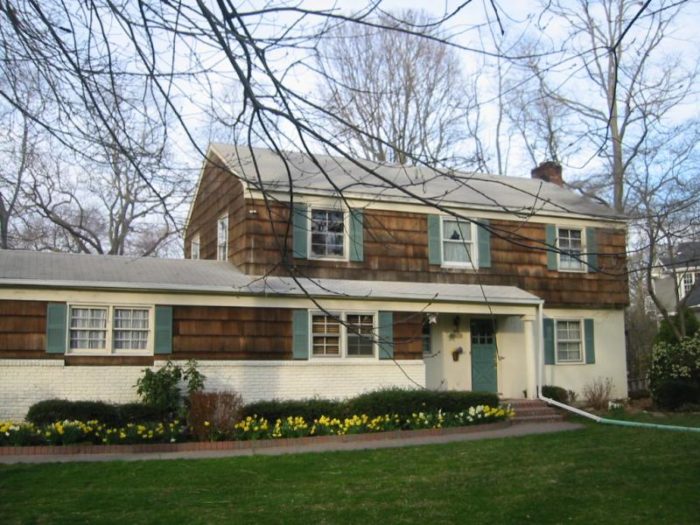

      We were out driving today and we got a bunch of ideas from homes we saw.  I've attached two pics of our house for your reference.  I'd like to put the stairs to the left with a six foot wide paver walkway along the garage to the driveway.  Along the walkway and against the garage I was planning to put three or four large pots or boxes with flowers.  We've been discussing the front steps option and may include a wide front step out onto the grass with just a cement pad at the bottom of the steps for a couple of doormats or an outdoor rug.
      When I consult with a customer I ty to throw all ideas out onto the table for their consideration whether they're conventional or not.  The less conventional ideas usually get more consideration than you'd think and often end up in the project.  I don't love being obligated to put the steps in the front just to 'frame' the door.  I also don't want to extend this new constuction too far out from the house in order to preserve the depth of the front yard.
      So, any suggestions or bright ideas?  The main problem is trying to convince my wife that the side entry isn't too unconventional to work with our house.

        1. barchiola2 | Jun 04, 2006 05:25am | #11
          thanks for all of the info and ideas everyone.  i think i'm beginning to see the inevitable here with two sets of steps being the solution.  the point that sitting and reading or eating or whatever on the steps is likely is a good one along with the point that there doesn't need to be a walkway to the front just because there happen to be steps there.  my wife and i have been going back and forth all day and we're finding common ground so that's good.
          the pictures look great even if they were done on the quick (for the right price!) and all are close to our original plan to add a more pronounced entryway instead of an 8' x 40' front porch.  i may even wrap the porch around the corner a few feet to make the roof line and corner space more interesting.
          i'll get to work on a set of drawings and we'll have to see how my schedule plays out.  if i have a permit in hand and a gap in my remodeling schedule i may just have to make the porch a reality.  i'm ballparking the materials at around $6500 which i think will add at least that much value to the house.
          thanks again.  well done.
          bart

        Your house is totally (well, except for the garage on one side) symetrical--I'd definitely put the porch steps and entrance right in the center. Mybe curve the walkway from the center over to the driveway. Or have two entrances--sort of "formal" and "informal".

    Where in Jersey are you? And what is that crazy thing attached to the chimney. Haven't seen one of them in a long time.
    1. barchiola2 | Jun 04, 2006 05:28am | #12
      that's the antennae we inherited when we bought the house.  I haven't had a chance yet to take it down although I almost knocked it over with a radio controlled glider I skipped off the roof last year.

        Bart, with the formal colonial design, I think you have to put steps in the front. How about a portico like porch with steps on all three sides. It could be square, say 12x12, or slightly rectangular. Or, if you want a long porch extending the length of the house, put a second set of steps all the way to the left. Make the porch at least 8 feet wide so you can use it. Above all - keep the wife happy : )By the way, I'm thinking of a larger front porch for our home. It's also a post war colonial (1960s) that has a small brick porch (4x11) with steps at the front, in-line with the door. The brick-like paver walk is 3-feet wide and runs parallel along the front of the house. The existing porch was improperly rebuilt with the same pavers. Sand and the concrete pavers are in contact with the wood sheathing. This construction has also settled and is now a tripping hazard. I'm thinking of tearing it out and building something as wide and a bit deeper out of wood. This would involve a gable over the porch. I have yet to draw it. My dad (also Bart) wants to tear his 6-foot deep porch off his house (also a colonial) and build a deeper porch. His has a concrete deck that is only one step above grade, and you approach the front door head-on. He wants to repair/extend the concrete deck and cap it with fieldstone, and remove and replace the roof to make the porch 8-feet deep.Any suggestions for my house would be appreciated.What is it with Barts and porches?Bart
        1. barchiola2 | Jun 04, 2006 04:32pm | #17

          it looks like you  have the elevation and slope to tear out the existing slab porch and redo it 8 or 10" lower.  If you can lower it enough then the existing roofline might be able to go the extra depth you're looking for without coming too low across the front.  If you have to you could demo the roof above the porch only and raise the new header a course of shingles closer to the windows and use the same slope to match the garage.  I'd probably steer away from wood though with it being so close to the gound.
          Once it's deeper you'll have the same question I've been kicking around though.  Steps around to the front or straight up the side?

    Personally, I see your house with a ~12'w x 8-12'd front porch with front stairs with a front facing gable.  A second set of stairs on the side would be OK, but would reduce the usable space on the porch.  It would seem that a 40'w porch would pretty much lock you into a shed roof or a low pitched hip, which, personally, I think would detract from the classic look of the current facade - especially the shed roof.    I don't know - maybe you want enough room out there for the whole clan :-)
    Also, personally I prefer to see posts set closer than 10'.
    Hey - here's a crazy idea... How about a 2 story porch which could have either 1 or 2 floors.  That would be classic colonial revival.   As it is now, with the entry like it is, it's more of a Georgian colonial.  A shed or low sloped single story hip would be more of a folk farm house type look.
    One thing that annoys me about modern houses is that many are such a smattering of styles, that they almost have no style.  Yours is not like that, but put the word style in your plans to expand - don't just think functionality.
