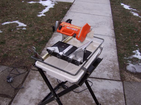

Hello,
Just picked up a Dewalt tile saw to allow 24″ tile cuts – no longer need my MK setup.
It is the MK660 saw with tub (motor replaced 2 years ago)
MK stand
newer blade (used one job)
45 degree bevel gauge
45 degree angle gauge
Rip fence
Wrenches
MK GFCI adapter plug
HeavyDuty Little Giant pump
The beauty of this saw is that it is QUIET! It is an induction motor and is virtually noiseless when running idle, unlike the cheaper saws that are based on grinder motors and scream when idle running.
This is a Pro-grade 7″ tile saw capable of cutting 14″ tile at 90 and 10″ tile at 45.
This entire complete setup would cost you over $800 if bought new online, I am selling the entire kit for $400. It is VERY clean – was cleaned after every use. Absolutely nothing wrong with it – just no longer need it.
If you have any tile work coming up, you’ll not be disappointed.
Call with any questions at 313-283-5908.
Julian
