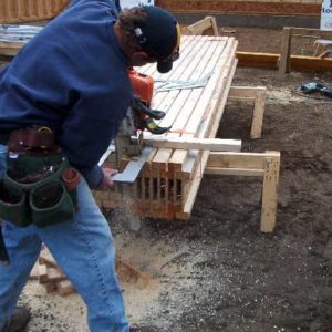

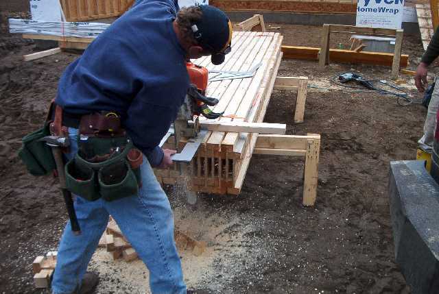

          dieselpig | Jul 31, 2006 01:34am | #16
          View ImageView Image

            zak | Jul 31, 2006 01:43am | #18
            Now you're talking.
            Worm drive?  Sidewinder?  fuhggetaboudit.zak
            "so it goes"
            dieselpig | Jul 31, 2006 01:47am | #19
            "Yeeee-HAW.... cut it with a chain-SAW!"
             That's my battle cry when that puppy comes out of the trailer.  :)  Sometimes we yell, "Yee-HAW, stick it in your grand MA"... but we gotta be careful with that stuff.View Image
            zak | Jul 31, 2006 01:54am | #20
            dangit, you're makin me get all teary eyed and nostalgic for my chainsaw days.  I used to carry an 046 magnum on my shoulder every day for work.  Back when people trusted me around sharp things.zak
            "so it goes"
            dieselpig | Jul 31, 2006 02:00am | #21
            Yeah... there's just something about chainsaws.....View Image
