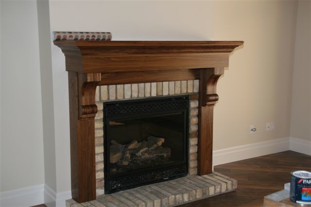

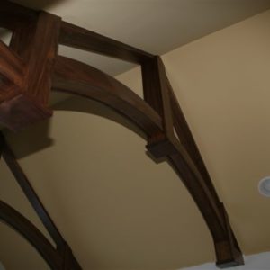

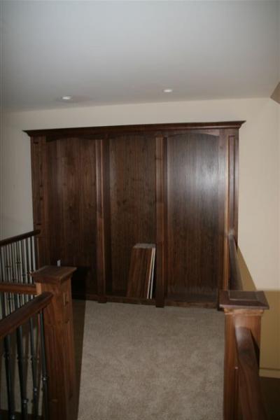

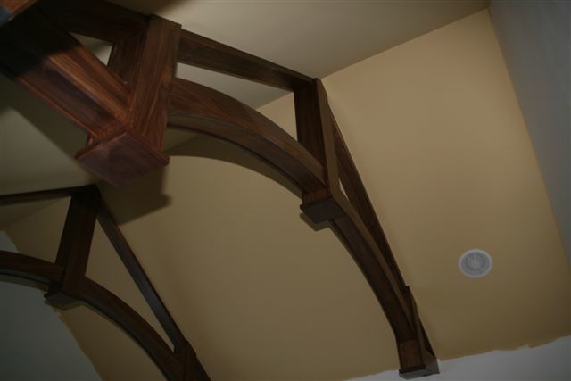

Hey, we all work for different types of customers. I have a builder that enjoys dressing up his models really well for the market that we’re in. ( I say “we” because I’ve been doing his work for 4 years now ) THese are pics of some of the items he put into his latest model. The walnut study arches turned out real sweet. (only 4th time we done them- other times in cherry, clear pine, paint grade) He is a super guy to work for , has a keen eye for detail, but would hurt himself if he tried to cut a piece of trim……

That is some great work there. Those study arches certainly did turn out well- I almost hate to ask, but how many man hours in those things?

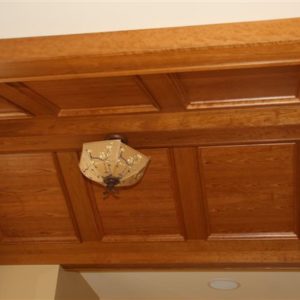

Was that cherry panel ceiling built in the shop as a unit and then set in place, or built in place? Edit: nevermind, I realize that it's bigger than I thought at first glance.

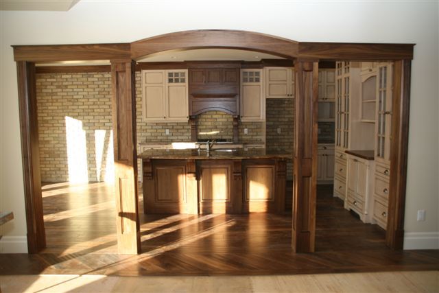

VERY impressive work. I particularly liked the mantle, bold yet simple... beautiful. I take it you laminated the corbels?

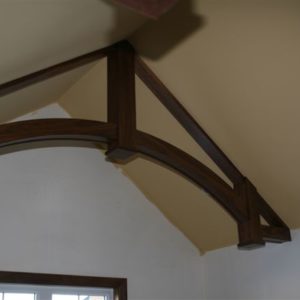

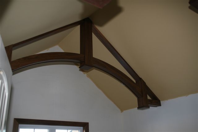

Thanks for the complement. The study arches have about 55 man hours into them. FIrst I layout everything on an end wall , get " approvals" , cut the arches and other materials, veneer the edges as appropriate, install the works finish sand and take pix......First we get good- then we get fast !

That walnut archway is a sharp looker. I wondered about the corbels too. That strikes me as something that would take a little forethought to pull them off well. How'd you do it? Nice stuff man.

The corbels were made by the kitchen guys as they had 6 to make for their own project (on the island and beside range hood). I get a design from the builder for everything including the corbels. Like I said he has a real keen eye for detail and will not settle for "my interpretation" (I've removed stuff that wasn't close enough at the beginning of our relationship. Now I ASK before proceeding) We have done the Great room arch in cherry, maple, clear pine, oak, paint grade and now walnut..(my personal fav is the cherry...)First we get good- then we get fast !

Very nice work. I especially like the arch, they're fun to do. In all my years of finish carpentry, believe it or not I have never done a coffered ceiling and would just love to. The first pict of the cherry vault reminded me.

Love it. Are the study arches structural or for show?
Piffin: Study arches are all show... scissor trusses hold up the roof/ ceiling
Edit: THe 2 inset panel posts on the arch between the kitchen and Great room are structural- they hide a 4 X 4 each.......

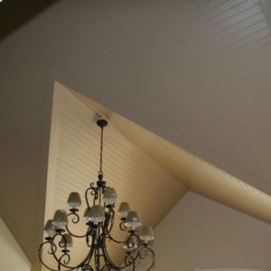

Hi all: Next group of pix. Most should be self explanatory and are in addition to the original group. At this home we also did the walk in closets (cherry to match ensuite ceiling), a beam ceiling in the Master bedroom (there is a grass cloth wallpaper to go in between the beams), a dropped crown in the dining room (allows rope lighting) as well as some other detail pix. Also is a pix of the back hall wainscot which is v-match T&G poplar (same as great room ceiling). The door in this picture is to the walnut pantry (sorry no pic!)

The bookcase is walnut particle core, veneer core and solid mouldings- no knots....... your ceiling looks good.... did you do the work yourself? if so , pat yourself on the back.... There is a lot of great trades ont this forum and I humbly like to share my work when it is special. I realize it is not the pinnacle of design or workmanship, but it is different and unique. If it isn't then, so be it......my intention was to share, not crow that I am the best.....

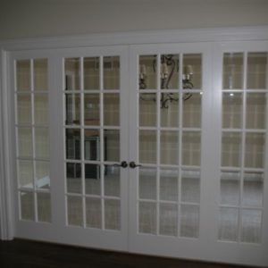

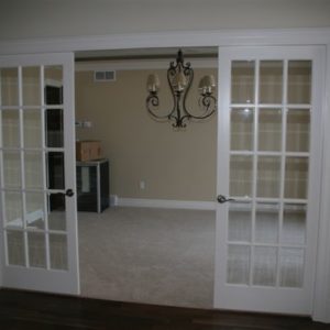

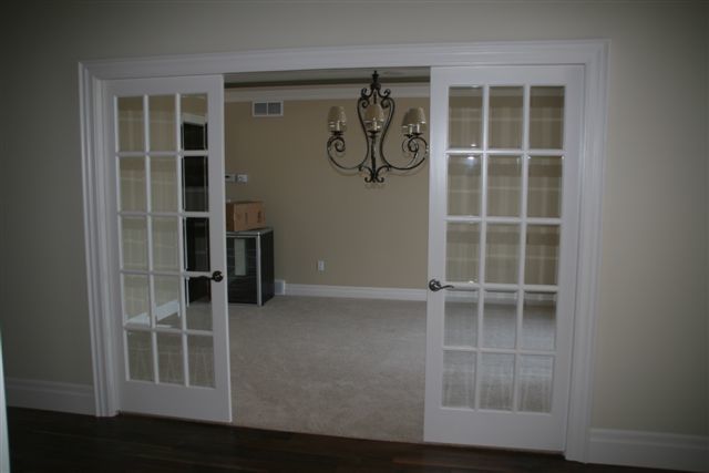

Very nice workmanship.How did you make up the pocket door track? I've got to do one tomorrow for double 4'x8' doors. We've got 3 3/0 Johnson I beam style tracks to cobble something together. I'm a little worried about the section transitions causing a hitch, how smoothly do those doors you showed roll? Outside of the gates the trucks were unloadin',

These doors are a 2'-8" plus a 2'-0" per side. This was done so the pane size of each door were the same when they were joined together (biscuited) . The framers put the tracks in and the joint seemed fine. The Johnson track was used as well in this install. We too were worried about the joint but it came together all right - the doors roll smooth but do have a slight hiccup when they jump the track at the connection. Making sure the joint is smooth , aligned and tight I would think, would be satisfactory(oops- don't forget straight and level !) This was our 2nd install like this- the other went equally well.
Hope that helps...... Joe
