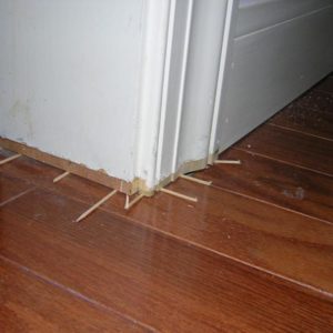

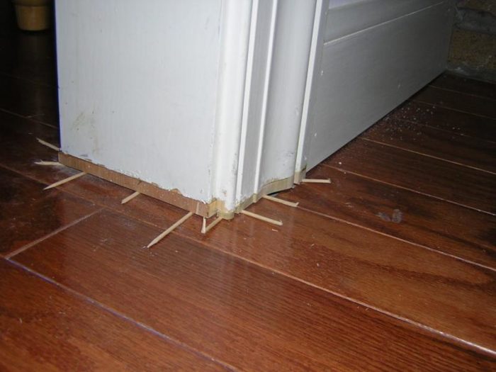

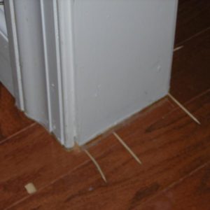

Or how to use yer brain and make mini wedges.
When I trimmed out this house a couple of years ago I didn’t expect the client to take up the carpet and put down a floating floor. Rather than take up the trim and redo it since it was anywhere from 1/8″-1/2″ off the floor I just cut and glued appropiate spacers. The tooth picks helped apply pressure while the glue dried. I did this for 14 openings and used less than 8′ of casing and 4′ of jamb material. Of course it’ll need paint but it would have anyway.
Edited 6/24/2006 10:22 pm by jagwah
