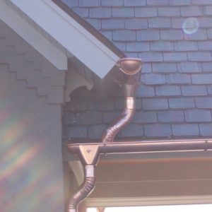

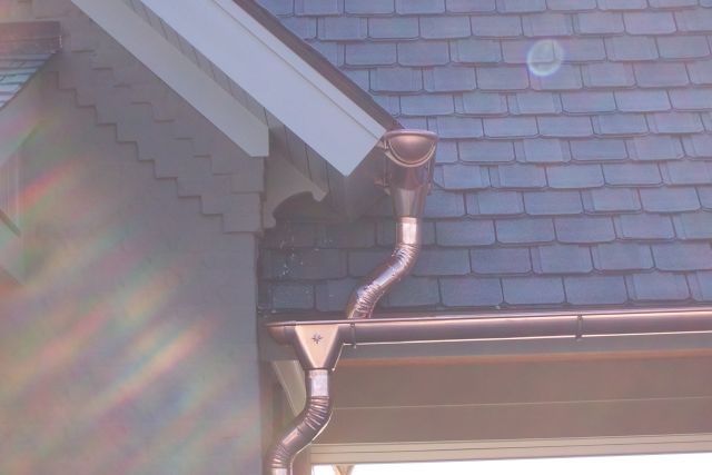

We have been playing with a different style of guttering than the norm. Custom cast hangers and endcaps that are, well, funky.
The Gutter is standard 6” half round, of which we hang miles of a year. The funk comes to play with facia that is not the normal plumb, but rather square tails, or even acute/obtuse from square from the plane of the roof…
“Think like water, think like water…”
We have hangers that are cast brass about a pound a pc. With a 4” SS lag bolt and 2 @ 2” SS hex head screws in each tail ( we don’t find subfascia too often on this one) so our math and attachments to rafters is a chore.

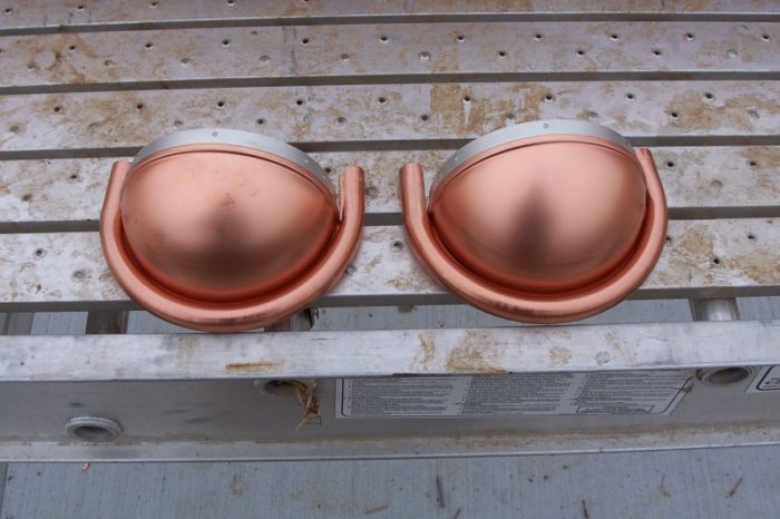

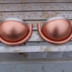

The end caps are custom caps and really stand out, but the end cuts on the gutter have to be dead on the nuts sq. to seat the seam. The saving grace is our drops for the downspout can be fudged up to an inch, and NO SOLDERING…that saves a LOT of time
The Site iView Images better than most, being as it is run by one of the best in the locale, they are good guys.
I guess the house runs about 6 million.
I included a pic of the new underwire bra for Colleen, sorry I didn’t model it, I am flat a s a board and easy to……..

    txlandlord | Nov 07, 2006 03:56am | #1
    Nice, very nice, maybe too nice drawing all the attention.
    Maybe 6 mil is the key...lots of other nice elements that cooperate with those funky fine gutters.

    Sphere | Nov 07, 2006 04:00am | #2
    Let's keep trying.  OK. Colleen, yer wear it, I'll solder you up.

    1. CAGIV | Nov 07, 2006 04:02am | #4
      send me a couple of them... I got an idea for my wife's next halloween costume

      CloudHidden | Nov 07, 2006 05:50am | #21
      Those things look like they're meant for dome gutters!!! (which is an oxymoron, but they're still cool looking)
        Sphere | Nov 07, 2006 06:02am | #22
        Now ya got me thinking..( that is never good)...I'll put'em on my van as headlite winkers( as soon as I get SG to wear a pair, I swear, I will.)

          BossHog | Nov 14, 2006 03:53pm | #25
          If you'll UPS me a pair, I'll take 'em to Memphest and maybe SG will model 'em for us.(-:.BTW - Nice work. Real impressive.

      diddidit | Nov 17, 2006 07:13pm | #30
      What's the cup size on that? Put a quarter in there so we can imagine the right size schtoobs to set in 'em...did<!---->Cure Diabetes - Death Valley 2006!<!---->

  4. lekpeter | Nov 07, 2006 04:35am | #8
    Sphere,
    Nice looking system, who is your supplier?
    lek
    putty and paint, make it what it ain't
      Sphere | Nov 07, 2006 04:45am | #13
      Gutter is Berger, parts are Classic Gutter Sys? and Grant Logan does the rest..AKA SeeYou here on BT.

    Gunner | Nov 07, 2006 04:40am | #11
      Sweet. Very interesting.

    JDRHI | Nov 14, 2006 05:20pm | #27
    Nice stuff Sphere.
    I've always considered gutters/leader work to be "finished plumbing".
    Unfortunately, too often it ends up looking like the rough plumber was left for the install.
