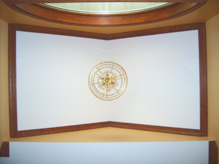

I put crown molding in a small vaulted entry today…took this photo laying on the floor looking up:
That is very interesting. Did you put an extra little piece in the corners in order to make the turn? I think that is what I see.
James
Yup.
That is a neat trick. How did you figure the angles on the small piece. For example, if the vault pitch is an 8/12 did you come 90 degrees out of the corner and then split the angle difference to go up?
We usually use crown blocks at these kind of junctures.
James
I think you have the idea.I picked up the technique from Gary Katz:http://www.garymkatz.com/TrimTechniques/cutting_crown_transitions.html

Yup. Same job.The large number of horizontals on that crown profile made fitting difficult...it took me a few attempts to get the hang of it...the flats had to be paper thin.Thanks for the nice comments.
