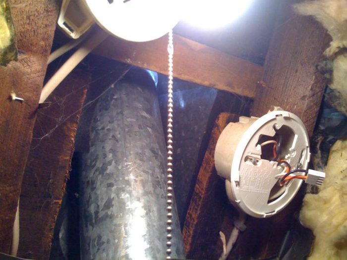

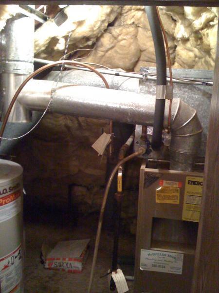

This is in Minnesota. I've attached a photo of the closet taken from the door and a photo of the heat detector that the homeowner unplugged because it is always going off. The fire marshall had her install a sheet of cement board and a piece of sheet metal on the rafters over the water heater. Apparently, he's satisfied with the situation as is. Oh, he came because the neighbors mechanical closet (same deal) started on fire several years ago.
>>Apparently, he's satisfied with the situation as is. Unfortunately, some FMs aren't as aware of combustion air requirements as they might be.And, human nature bing what it is, sometimes folks focused on one issue don't even think about others.
